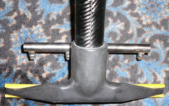

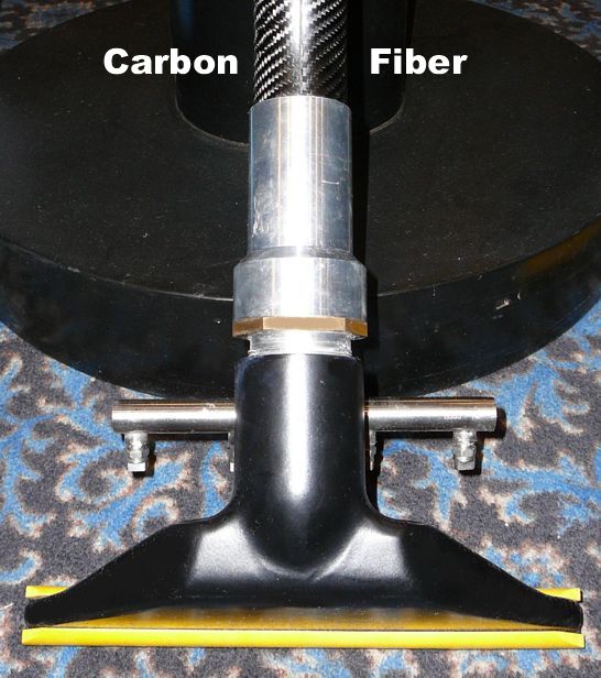

The Bentleys from Mytee were the ones I thought had the features, I was looking for.
This is the 2" Carbon Fiber model, which had the best vac head design and only weighed about 7#:
It had a nice overlap of jet spray. I thought the jets needed to be slightly more vertical.

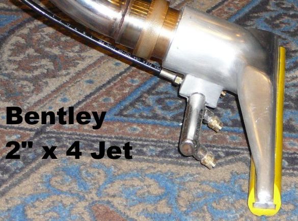

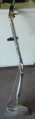

Next was the same model with a new swivel assembly:
It enables you to clean under beds and around furniture.

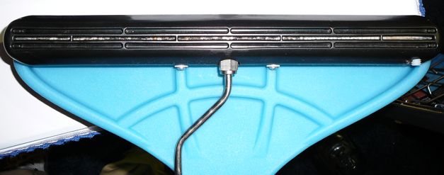

The updated Stryker from Legends was next.
It has 96 jets across the 14" width and 2 vac slots ------ (white cleanout at right):
Here is a closeup of the jet assembly: (equivalent to 3.5 jet)
I have some concerns about the jets clogging,
and the rotomolded head durability.

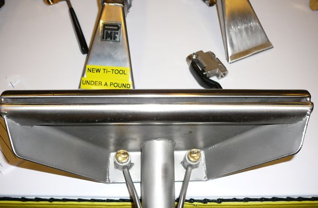

PMF also had a couple of interesting wands.
First, a 14" wand with round SS glide:
Above the wand is their new Titanium upholstery tool.
It was less than 1 pound.
Prochem Titantium Excess Wand Plumbing:
There was also a ~12" Residential Zipper Dual-Draw Vacuum Head Carpet Cleaning Tool,
as well as the 15" Blue model.

Regarding the Stryker the flow is 1 gallon per minute at 375 PSI using a CAT 3CP (1500 PSI) pump and 50 feet of solution hose. Of course more solution hose + more disconnects increases restrictions and affects flow so increased presuure may be needed. Regarding cleaning the Stryker actually has a self cleaning feature which I believe makes it the only wand on the market that does.
We had a traditional handle design available for people to make a comparison to at connections and while most people expected the traditional design to be more comfortable before the comparing to the Ergo Handle design a significant majority found the Ergo design more comfortable after only a couple of minutes. Thats not to say we won't offer a traditional design in the future.
Additionally I'm pretty certain that the Stryker has more R&D hours in it than any of it's current competitors given thatwe went well beyond the traditional design in terms of cleaning performance, extraction efficiency, glide efficiency, ergonomics, weight and durability.

Hi Bill;
One of the guys at the booth pointed out the threaded nylon fitting at the right end of the picture above for clean-out.
But, how does it actually work to clean out the 96 jets ?
Does it just flow water past the 96 holes ?

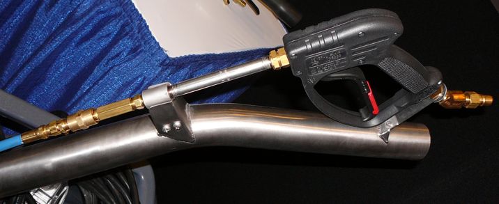

Are you going to put a trigger valve on it.
The ball valve design stops me from purchasing one.

Opening the fitting subjects the inside of the manifold to vacuum which when combined with the flow of water cleans the inside of the manifold it's just another feature that Keith and Roy brought to the project based on years of real world experience. We all knew from the beginning that keeping the manifold operating and clean needed a simple built in solution

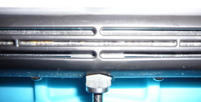

Customers month-old TM wand:
. This is why I always look for durability on all of the wands at Connections.
The Mytee has a round stainless manifold.
It mounts on a 2" wide half-round section in the aluminum head casting.
It can swivel rotationally, and has a half-round clamp that goes over the round jet bar.
