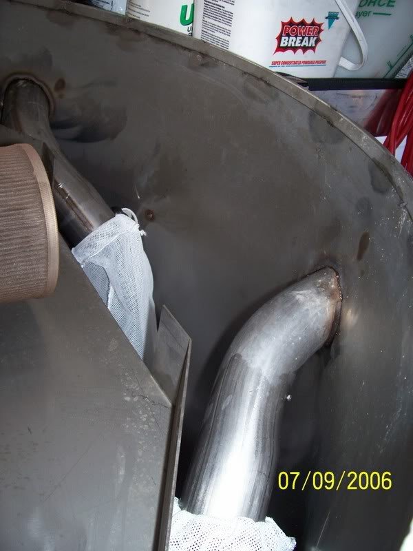

The best thing I ever did. That kit looks really good. AT did a good job on that. I had a local welder do all of mine. I think everything cost about $440, metal and welding. I got a good deal.
I dumped the filter sock in about 10 min. of use.

The FlowEzy filter(s) at the top look to be pretty loaded up too. Spin them off and clean them from the inside out. Hope there is more than one??

There is 3 filters and the discoloration you see is the pantyose that I have on the filters. I clean mine everyday.

I see the kneehigh cover, but I was speaking of the stuff in the pleats, especially noticed at the ends. If you pressure wash the filter out from the inside it looks like you could blow that out.
We run two 3" ss Flowezy filters on each of our little 47's, so three sounds about right for the bigger blowers. I've seen a bunch of 405's with the fitting reduced to use a 2" filter...bad economics.
