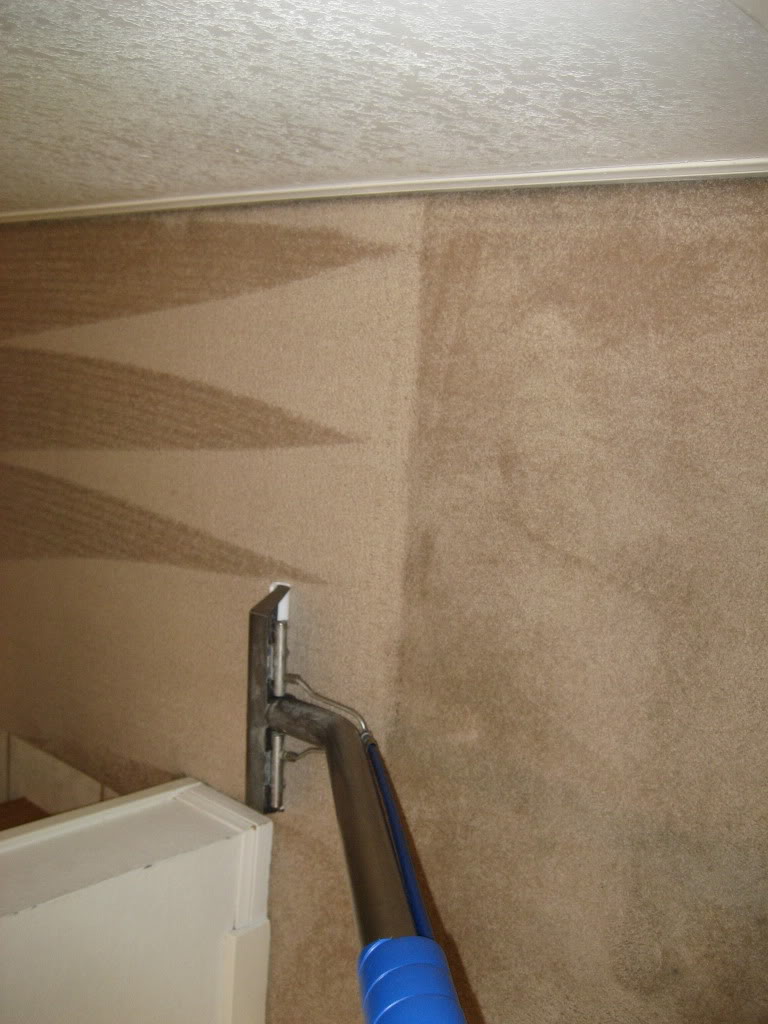

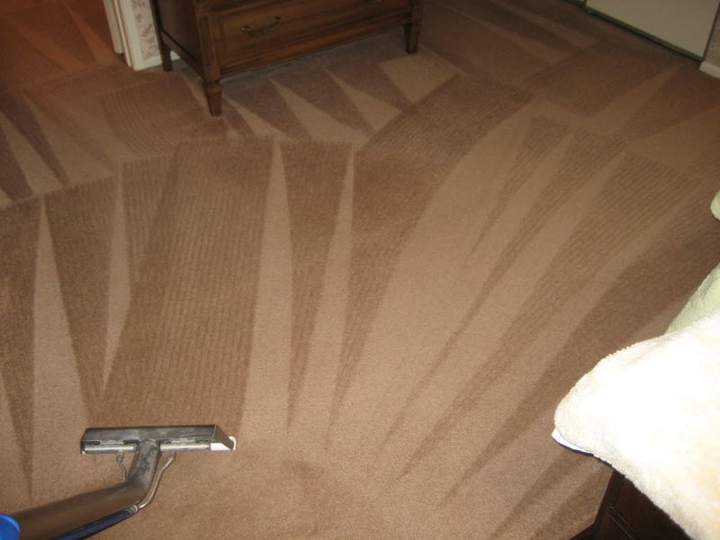

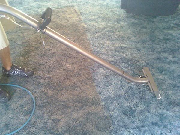

A few photos of the O2 system

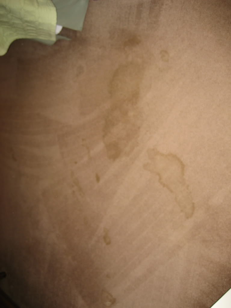

This photo is turned and is the same area you will see in the other photo. It captures the corner of the bed towards the nightstand area
