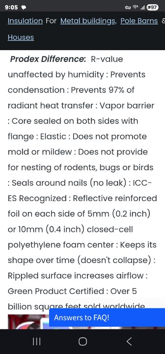

Reflectix bubble insulation is thin and claims a high R value, but part of me feels that something close to 2" thick will do better than some shiny bubble wrap.

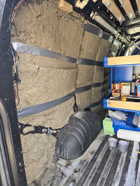

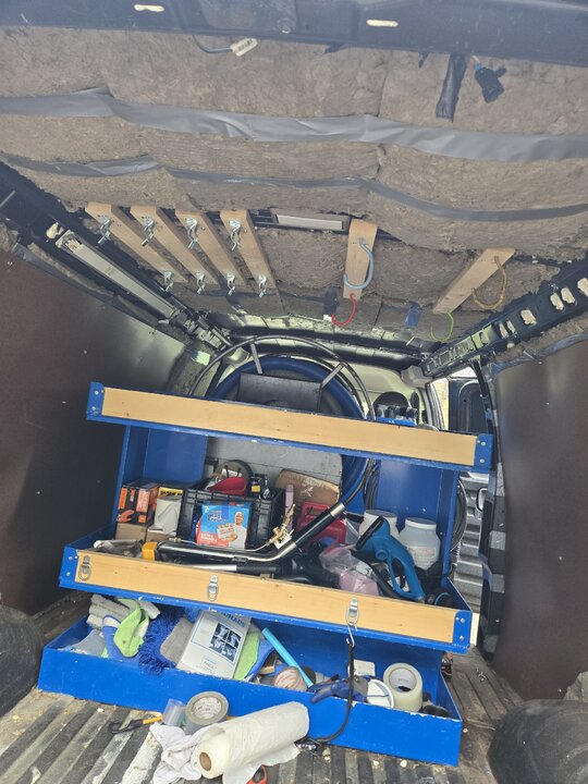

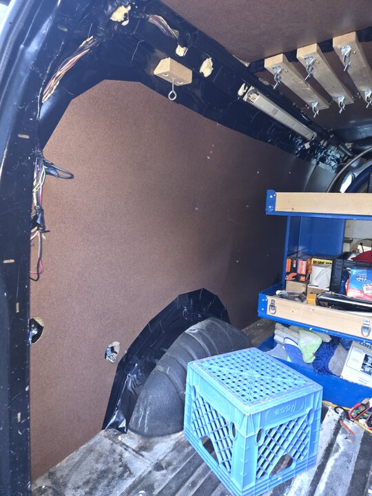

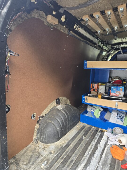

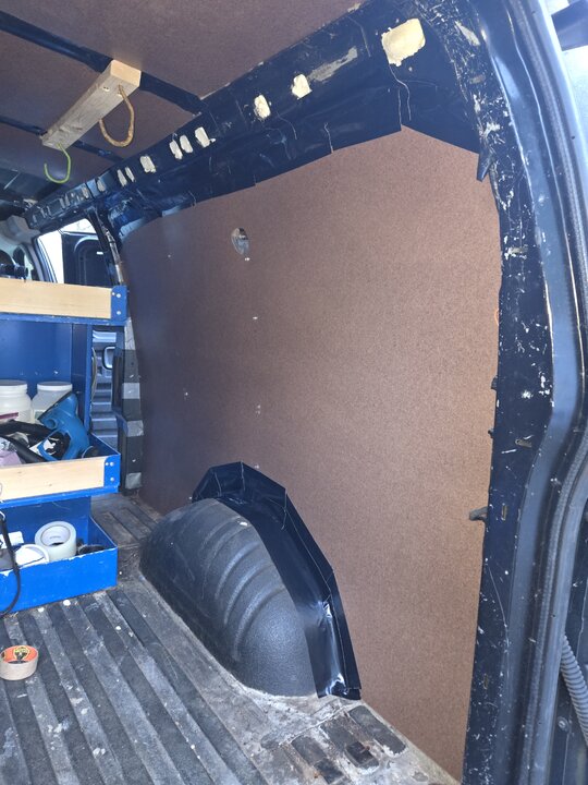

I'm going with rockwool batt insulation covered with masonite screwed into the sheet metal ribs. I think it will look nice, and it is a great insulator. The rockwool is less susceptible to moisture problems than fiberglass. I'll seal all the sheet metal ribs or whatever they are called with expanding foam, and test the roof ones first to ensure they dont push the exterior sheet metal outwards and make it look weird.

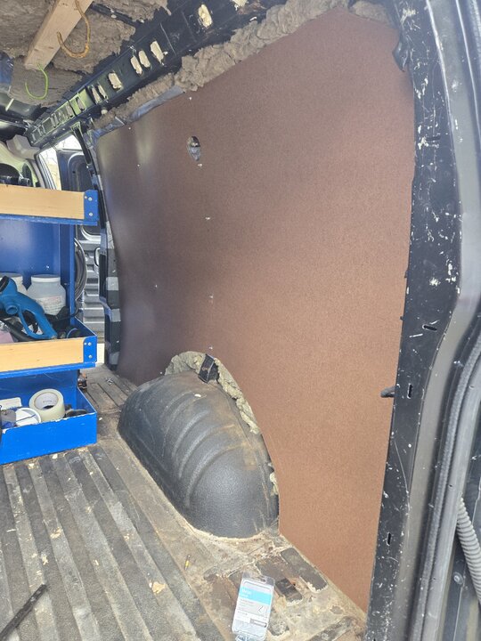

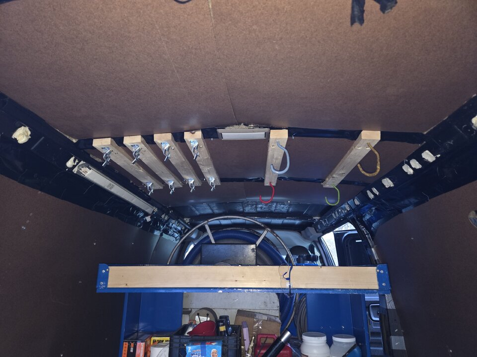

This took me all weekend. Everything takes a long time. There are 2 more sections to do over the waste tank, and I will do this to parts of the doors too. I think it came out good enough. Thanks for saying something about how awful the insulation would look Woody. Thinking about covering it from the beginning helped it all come together. This thing will be toasty warm!

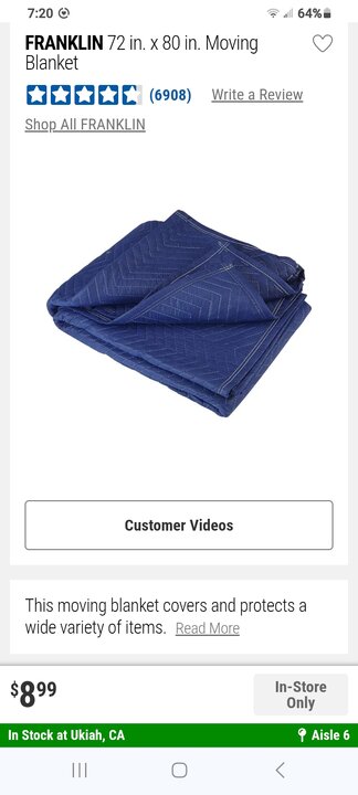

Next weekend I am going to epoxy my waste tank, finally received the Caswell gas tank epoxy. Then I can insulate the floor and put plywood over it in the rear storage area. Probably pink foam board and osb. Not sure what to do to insulate around all my plumbing and the power pack. I'd just stuff rock wool all around it but I don't want to be inhaling rock wool particles all the time. Nor do I want a mess of loose junk around all my hoses and machine parts. Maybe I'll just get a few blankets from the thrift store and chop em up.
If you're going to use blankets, consider moving blankets they are really thick snd are 6'×6¾' harbor has um for 9 bucks each
