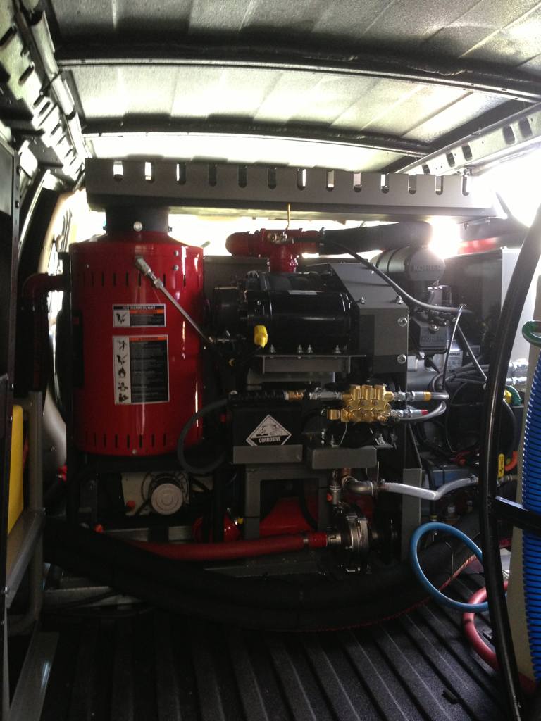

Amtex Dragon 4047 going strong for three months now absolutely no mechanical problems!!!
I gladly Explained to Mikey that it has pushbutton to start the Northstar heater!!!

I have a van divider one of those snap on types with two windows. It's not in the picture because I hadn't re-installed it yet so it's quite comfortable in my Chevy van but in Houston we usually have to have the AC on year around. I thought it would be really hot because of the Norstar but it's no problem at all.

I run that same northstar, when done just shut the burner off run the machine for 2 minutes to dump / run cold water thrue it and thats it.
That damn thing can run so fricking hot it would be bad idea to just shot it all off at full heat...
VAn got way hotter when I had the heat exchanger, the northstar is very well insulated and when wented out it will make your van barely warmer...
