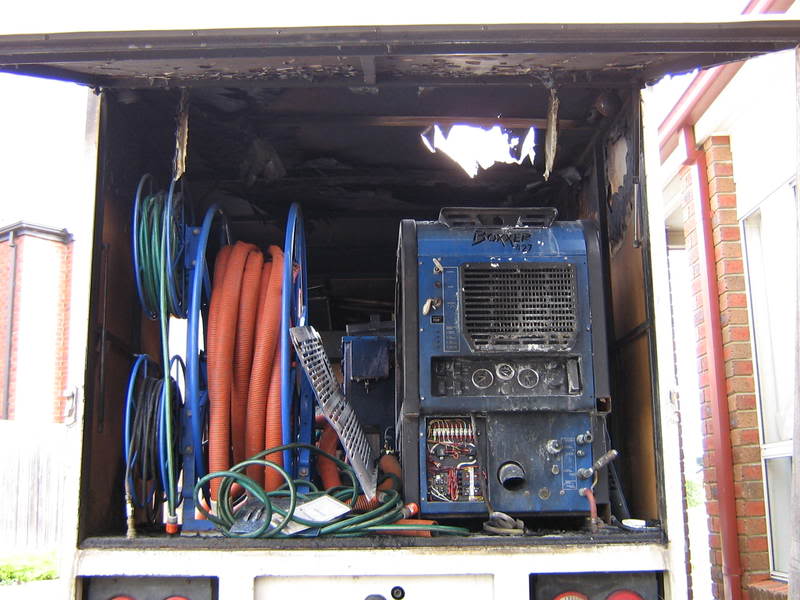

I do have to disagree with Shawn and Micah. Even though the 427 is a great machine I have seen far less issues with the Maxx and it is capable of a lot more. The only downfall of the 427 is the coupler. That thing drives me nuts.

Here ya go :)

:p I only said it was my favorite Hydrmaster Picture. It only had 500 hours on it and was 11 months old. The fire didn't start until they where wrapped up and driving home. Could have been really really ugly.
Interlink had to yank it and send it back to hydramaster to completly re-wire and re-plump it. Personally I wouldn't have taken nothing less then a new machine. I am still waiting for them to call me and tell me it burned to the ground.
Chris i'll go take pics of the 427 we have here that is in peices and get the ones of the one that was sent back to Interlink in peices if that would make you feel better :lol:

Geezus, I own a 427 900hrs nothing major. What's the story with that pic?
