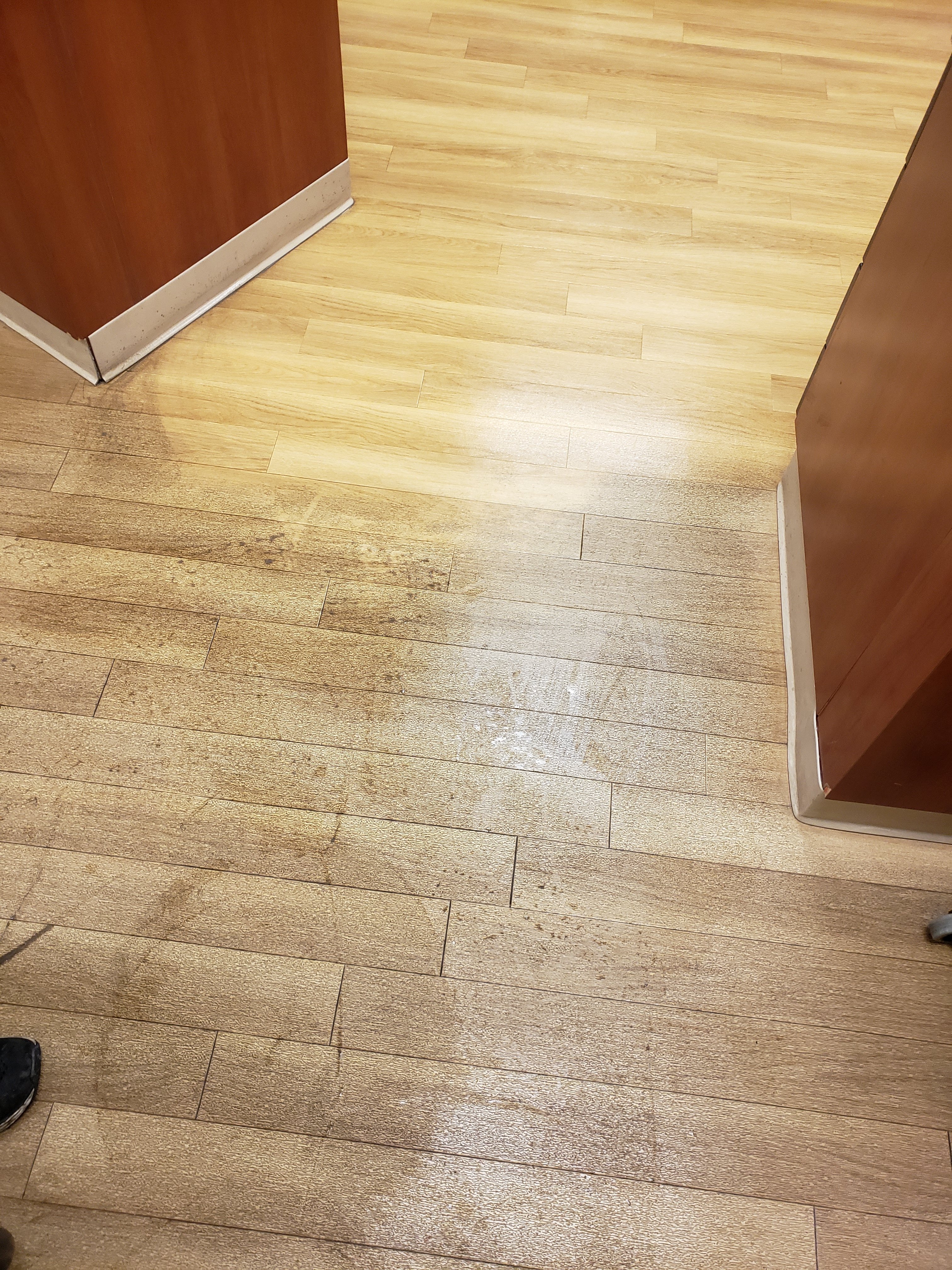

Are you cleaning LVP?

We clean it. People are surprised at how dirty it gets.
