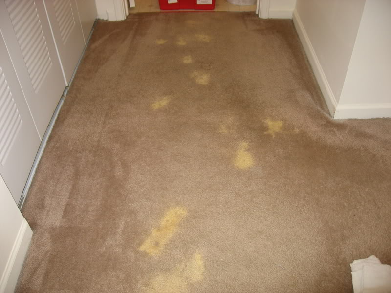

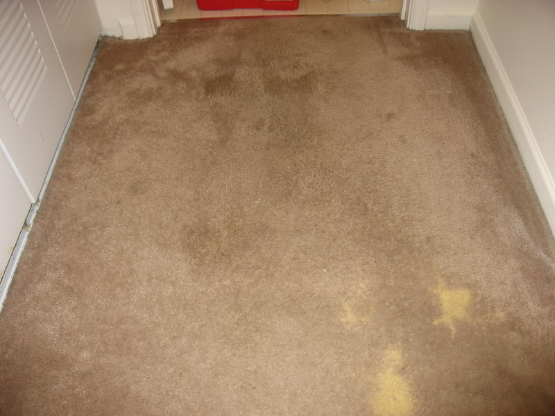

If not, why? It is fun, easy, and profitable. I did this yesterday. The customer is a 91 year old man who had an accident in his apartment. He tried to clean it with bleach. They want to charge him for replacement (for obvious reasons) and he is fretting about the money. I am not charging him full price for this, and should be able to save him from having to replace it. The after pic IS darker in the dyed areas because it is still wet, and I know it is not PERFECT. This one is so bad we are just looking to make the manager happy enough so she won't charge him.. I feel sorry for the guy and keep thinking how I would want someone to handle it if it were my parents or other family.
Before
After
There are probably about 40 spots like this. I just dyed a few to see if it will satisfy the aparment manager. I enjoy this more than cleaning!

I don't do it because when I took the class a few years back, I couldn't ever get the dyes to take. Maybe I had a bad batch or something. Plus, I was under the impression that you couldn't dye polyester carpets, and Lord knows, poly is about 90% of what I see.
Fon Johnson
Oct 15, 2006
1,066
Your water was not hot enough, you did not neuatralize, or the dye receptors were too damaged. I had a tough time with this one, and one from last week with damaged receptors. Even at that, you can still repair these and Poly Esther too..

Not that I know of. I have not had to use them yet. I use dye, and can usually get them within 95% improvement anyway.

They don't look photoshopped to me, you can see the differences of pile laying in different directions with lighter and darker shades.
Also, the Urine didn't cause the colour loss, the bleach did. Of course the bleach mark will be bigger than the urine mark.

Marty, a couple of possible causes apart from what Fon said.
Water not hot enough.
Bleach was not neutralised.
Also, if it was an SDN, the dye blockers could also be resisting the new dyes. :shock:
New colour was not heat set. :?:
