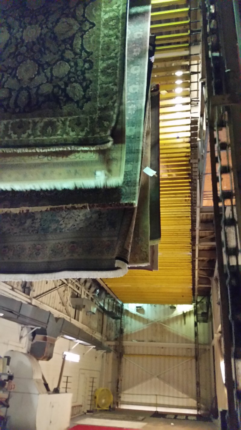

Area rug cleaning is really becoming popular with people having a lot of mixed flooring these days. I started like you, bring home small rugs and hanging them wherever but that gets old fast. You can clean rugs in your garage but you need to dedicate the space to that function. I now have a small shop, after renting garage space here and there. I am still a bit of a hack, no wash pit, no centrifuge. I clean by hwe, supplemented by shampooing, some vlm, a homemade rug sucker and a watering can. When I am done, I have my racks suspended from the ceiling on a block and tackle pulley system. I am using 1 inch steel plumbing pipe covered with a 4 inch diameter white abs plastic tube. I like the 4 inch tube because it doesn't put a bulge in the carpet while it's drying. When I am done with the carpet, I lower the tube (rack), pull it up on my pulley system and tie it off on the side. I do have a concrete pad outside where I can saturate a rug with a hose if necessary and I use my home made rug sucker to remove the moisture. I will be looking to buy the real one on these days but it's probably #4 on my list of priorities. Need a few more tools before that like a Zipper, rotovac, etc. Take a good look at the homes in your area and see if you want to invest a little more in rug cleaning. Check what the competition is getting price wise and instead of lowballing, raise your prices to where you are at least going to make some money on. Remember, pickup and delivery is extra.

My rug drying racks are very economical .when I built my shop I had the trusses engineered o hold the extra weight of the rugs and spread the weight out over the different trussses with four by sixes. the poles are made from bci's skined with quarter inch plywood for sheer. I paid about five or six hundred bucks for a 110 winch to raise and lower each drying rack and each one is 16 feet long. Not a big operation but I can wash as many rugs as we can physically do with a small operation and dry them in one day. I also use wire rope for the rigging. We have 12 foot walls in the shop plus scissor trusses so the height is approximately 20 feet so we can walk under the rugs while they're drying.
