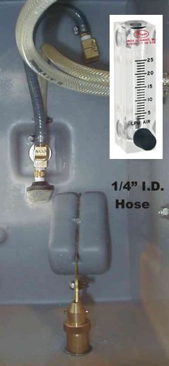

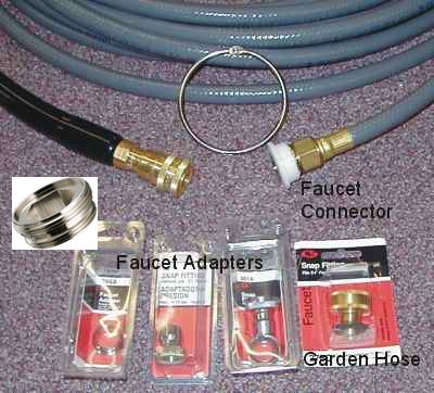

Scott;
These are a few of the parts:
The stainless steel flowmeter & 50 ft. hose with QC's, adapters are just part of the system.
About $150 in parts cost alone, without labor.
An injector will NOT work unless you have a special inlet system.
Larry

thanks Larry, thats exactly what i was looking for. makes more sense now. Do all manufacturers that u know of include the chem draw system with the auto fills?
