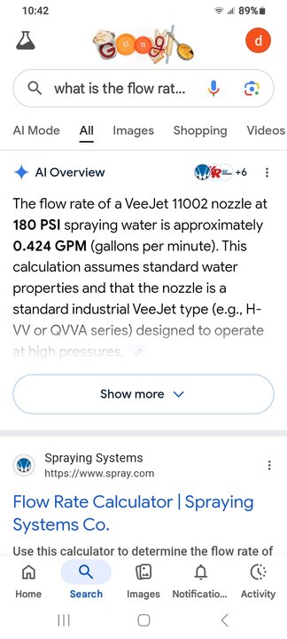

Tried to find the answer for you no google but after asking the exact same question 4 times and getting 3 different answer. I deleted the information. I can send you a standard spraying systems flow chart and the math to modify the psi if youd like. Or go with what Google tells you i asked " what's the flow rate of a 11002 vee-jet @ 180psi spraying water" when i add spraying water the answer was the same twice
