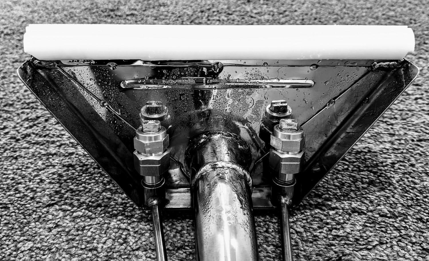

I'm not interested in making tools when I can make unexceptional tools, exceptional...
for example
