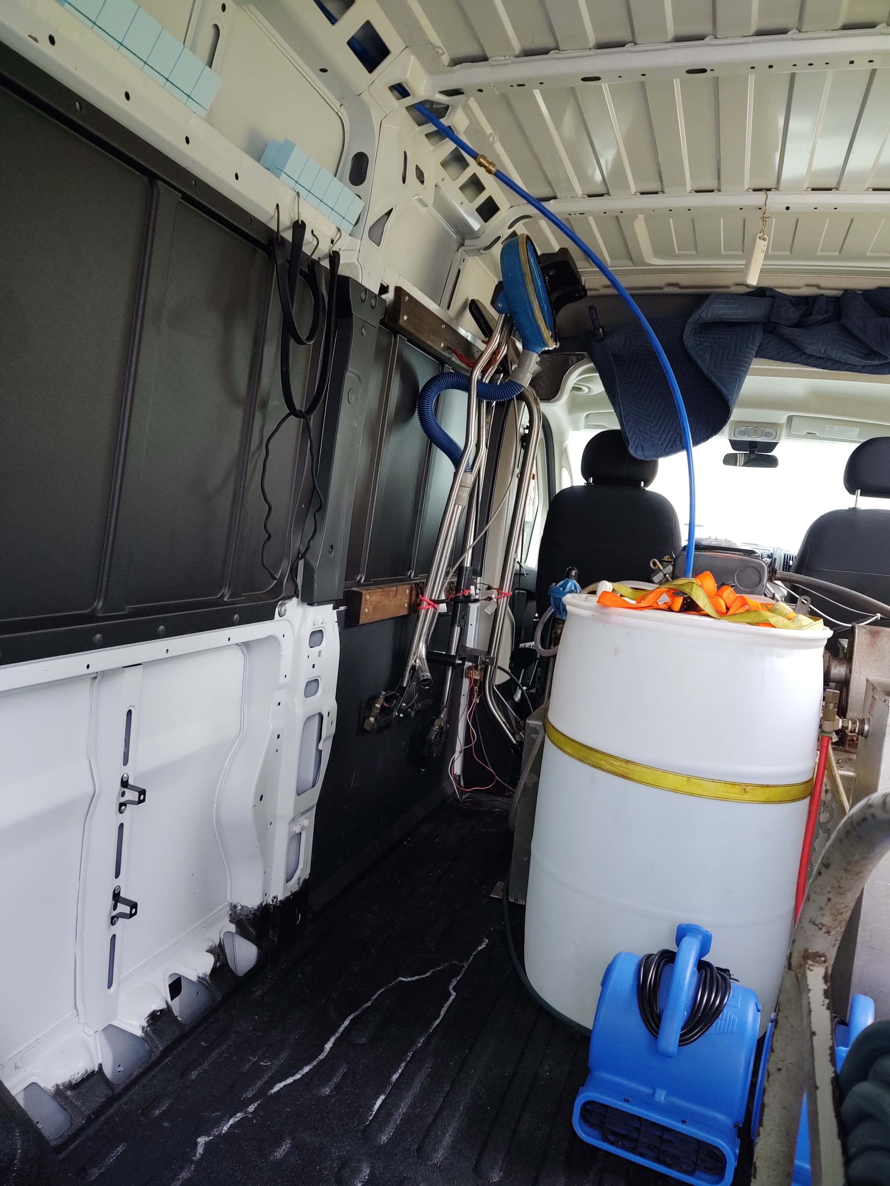

Ok what is the trick to getting the white soap residue off the coated floor??
I should of rinsed as soon as it happens.
But eye didn't.
Presprayed and scrubbed with deck brush then used 600psi to rinse with pressure gun.
1,846
N GA
BradFenstermaker
Thanks
So there is nothing that will actually remove it??
I may try some all fiber rinse and scrub by hand with brush.
I have black paint already if all else fails.
Marty you trying to get me to ruin my floor or will that work?

Park on a slope with the front of the van higher, obviously.
Mix up some tile cleaner.... Tsunami seems to be the flavour of the month. ( mix half strength).
Put in small pump up, or trigger sprayer.
Apply chemical, scrub with stiff brush.
Rinse with HOT water, using your TM, with a pressure washing wand.
Apply double strength cleaning vinegar, full strength. Scrub again.
Rinse again.
Let dry.
Apply Aerospace 303, or the stuff Mike likes to use.....
PROBLEM SOLVED....
How do I know? Cause when mine gets white streaks, that’s what I do, and it looks brand new again....
Thank me later....

I also did herculiner in my van. It doesn't harden up like the linex stuff.
Next bath day I will try super high ph followed with vinegar and see what happens..

Brad, you have to make sure to use a protective layer, such as Aerospace 303, or the product from Stoner, Trim Shine.... it will look new, or even better than new....
Reactions: BradFenstermaker

I have so much room in my extended promaster I may have to wear a helmet inside if I am running around grabbing tools.
Is trim shine slippery when wet?
