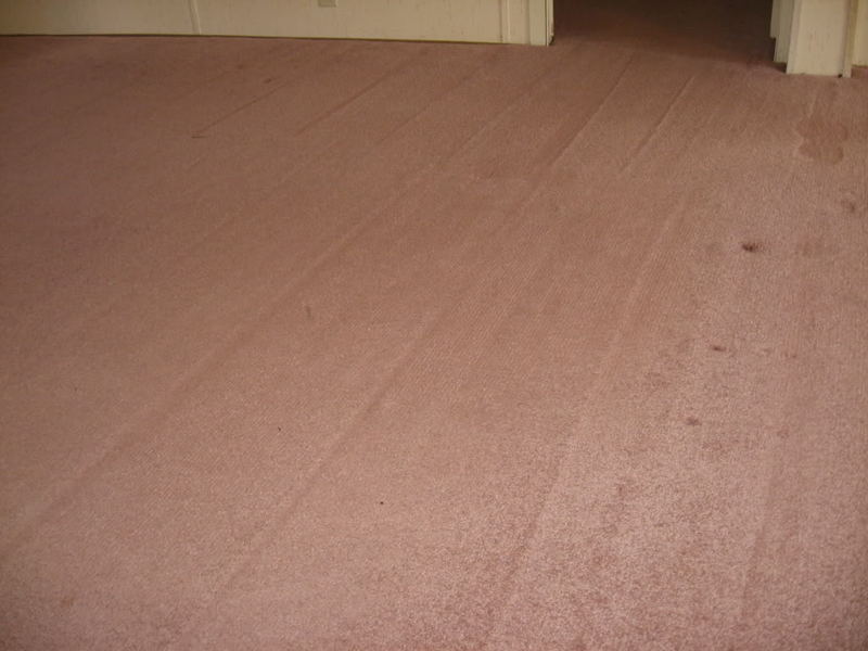

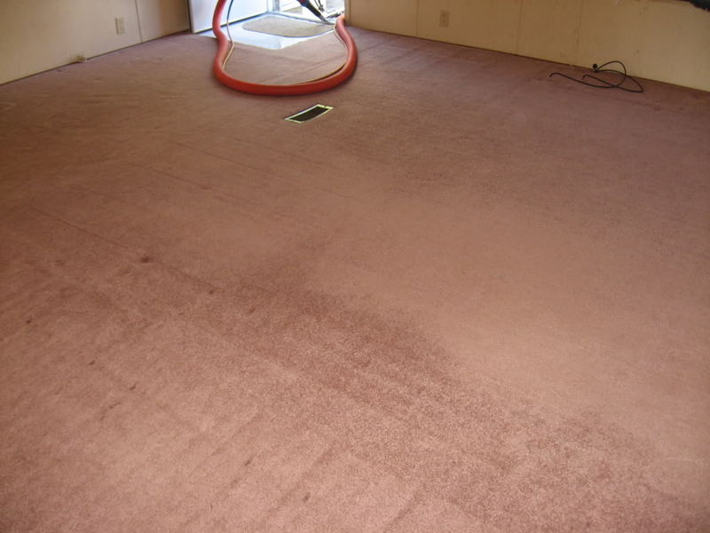

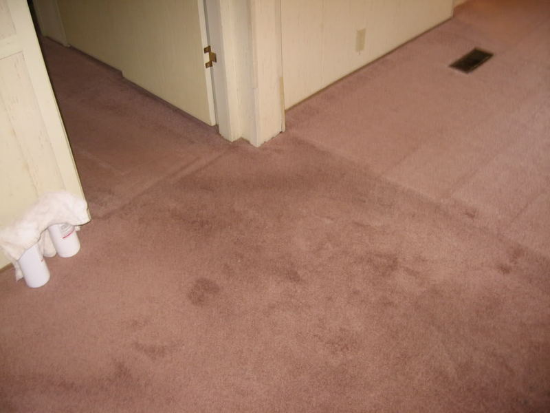

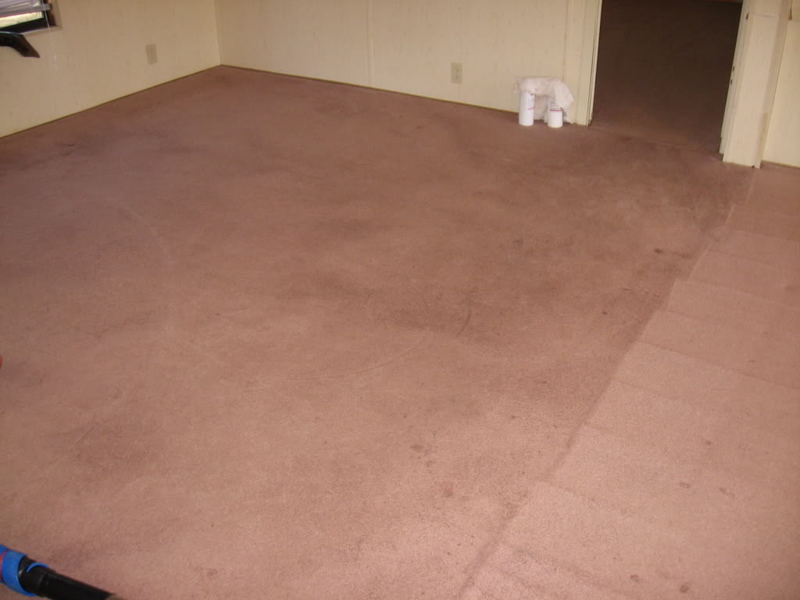

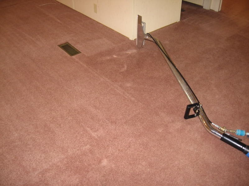

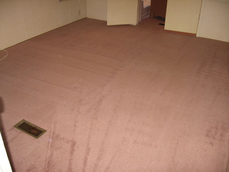

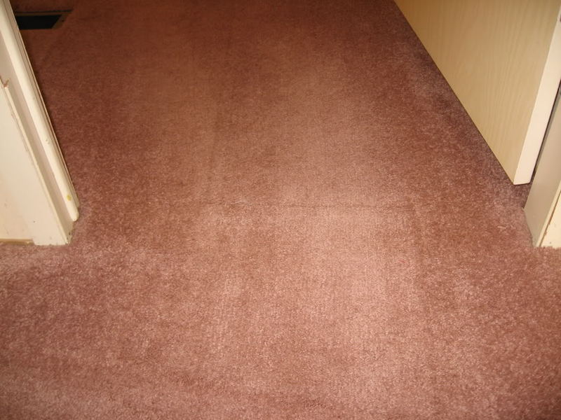

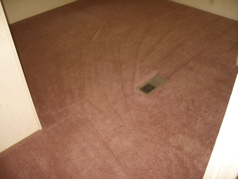

This is a rental of my in-laws so it was a non paying job. Anyways here's some before and afters. I'd say it was a light to moderate soil job. So it got PS, dwell and rinse. There is a lot of wear on it for sure.
The following 2 show traffic lane grey
view from other side of previous pic and it's also an after of the 5th pic.
Here is the 1 arm greenhorn in action for Bawb

Does that wand have jet extenders? I'm guessing no because of all the vapor.
If it does, I need more heat.

Yeah it's a greenhorn it comes standard with the extenders. I'm running 10 flow. The reason it steamed so much was because it was around 60 degrees in the place. There was no heat run last night in it and it was down to like 45 i think last night. It was around 11:00 when I did that or so I can't remember.
But I layed the wand down and took most of those pictures and started the video. I'd say atm it was 230-250 somewhere in that ball park cause it was sitting a few minutes. I run a cds 4.8 with the blower exchanger. I was running 100 ft of the parker themoplastic hose, also at 500 psi. It did steam all the time mostly cause it was cold. Most residential I get a little bit of steam though, my tm keeps 210-220 ish in the winter and a bit warmer in the summer. Although on cgd jobs it steams like that all the time if not worse at times.
