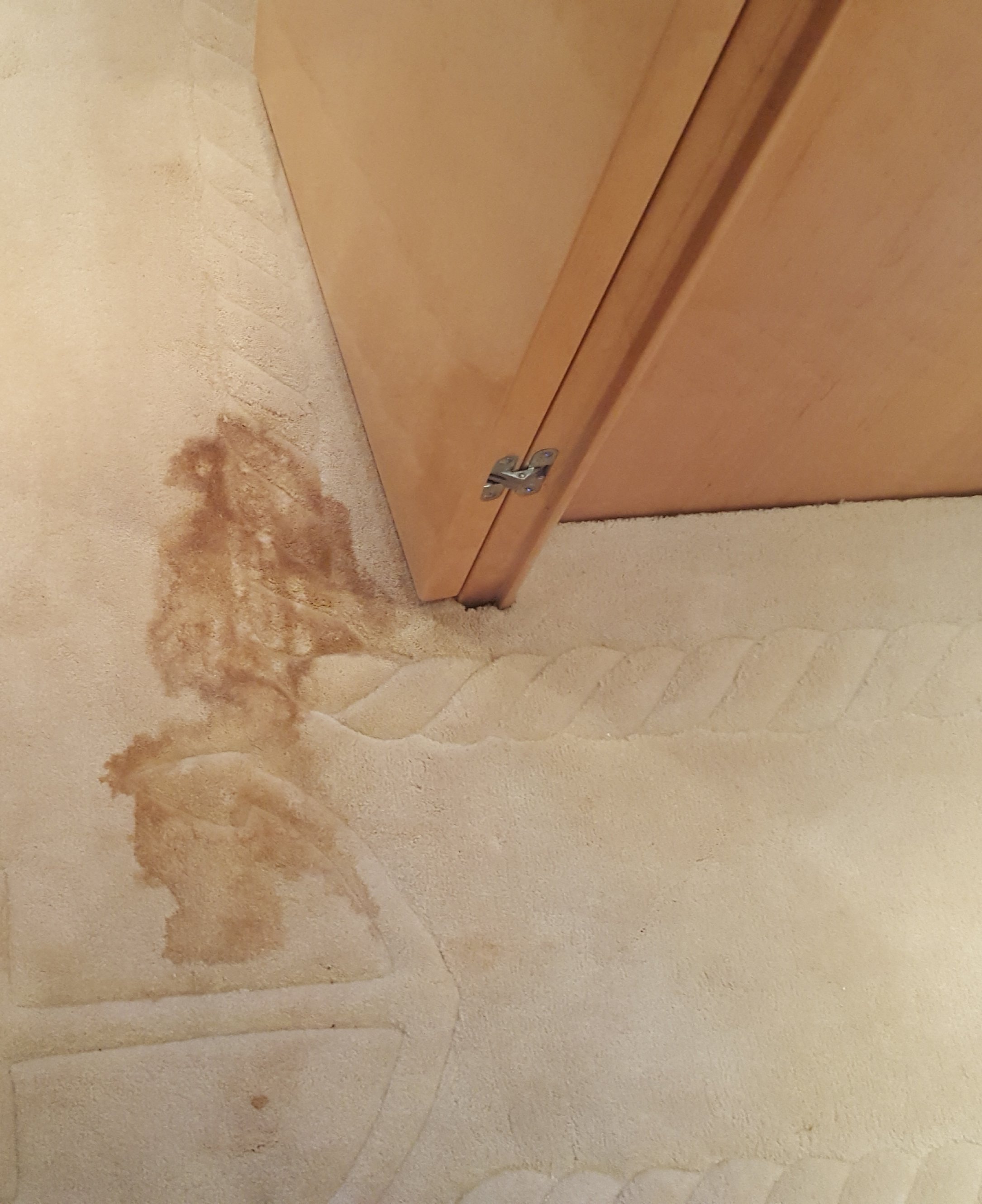

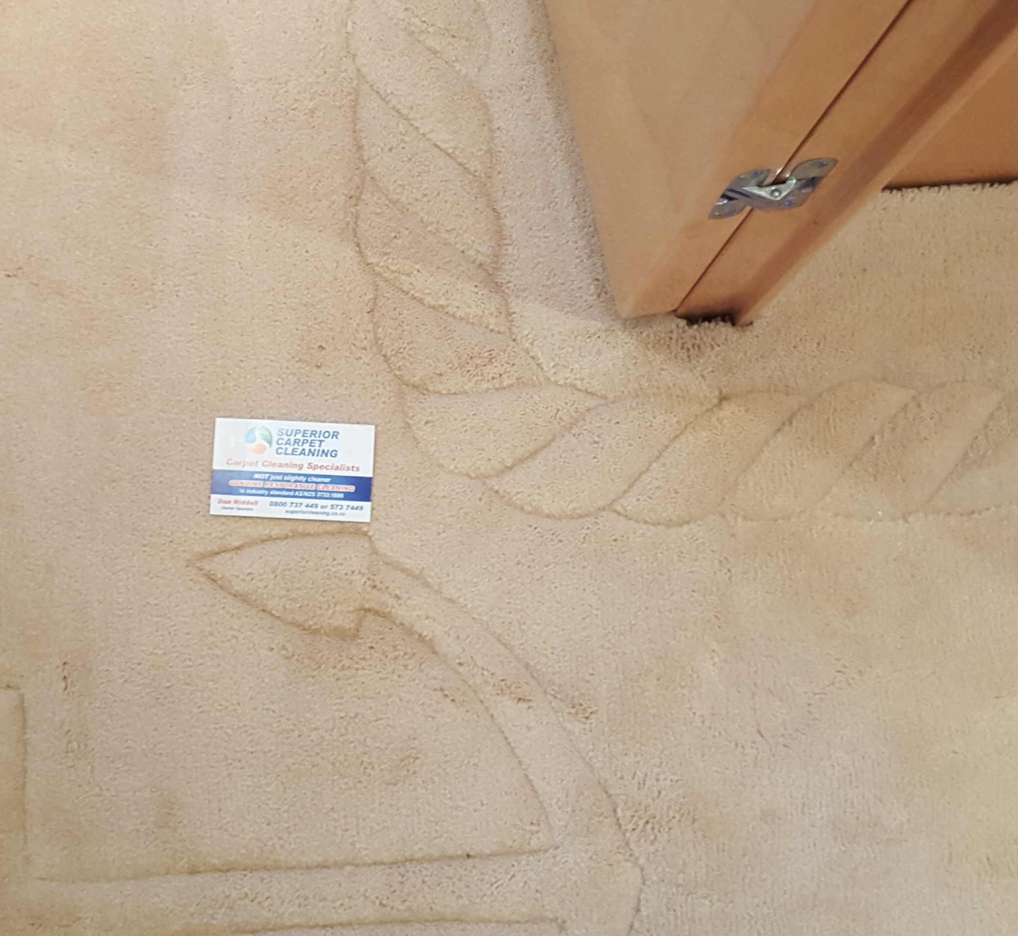

best coffee stain remover hands down
Tom Forsythe
Dec 19, 2006
486
Red Zone Ready is twice the strength of a recommended dilution of the powdered coffee stain remover. When you neutralize sodium metabisulfite from a pH of 3 to a pH of 7, the odor goes away as evidenced by Red Zone Ready. It is similar to ammonia as the odor is at pH of 12 and when it falls below pH of 9 the odor goes away. Neutralizing the powder is probelmatic, but even our liquid browning treatment we left with the odor as our perception was that customers would not believe it worked without the odor.
Peroxides work best with organic (caffeinated) coffee and reducers work best with synthetic dyed (decaffeinated) coffee. Some of the better de-caffeinated coffees process the caffeine out without removing the natural color. I visited a coffee plantation when I was in Hawaii (Kona area a few years back) and they processed their decaffeinated coffee without removing the natural color.
