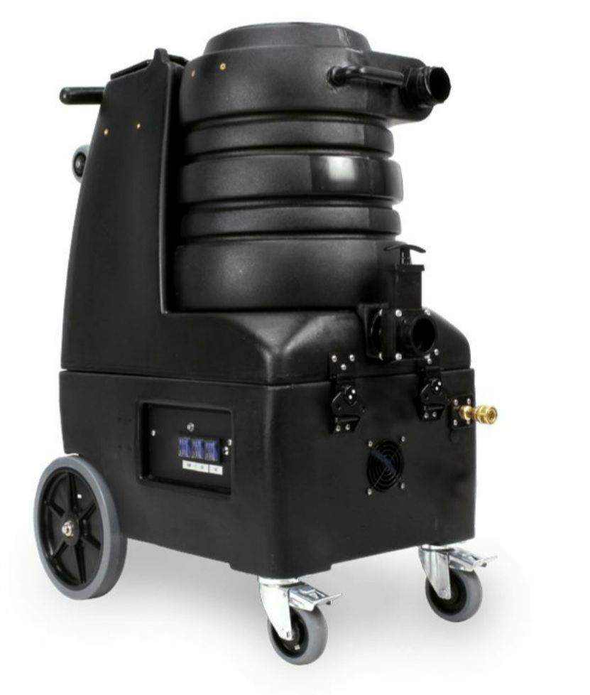

In that case, the nautilus would be a great machine. Heavy but manageable as long as you don't have to go up stairs with it. The 2 8.4 inch vacs can be configured for series or parallel. In parallel with a 50 foot 2 inch hose, the vacuum is incredible. You will get great drying times. The 500 psi pump makes cleaning a breeze. It can be prone to blowing circuit breakers on the circuit with the pump and vac motor. Usually needs a 20 amp circuit. The other cord is fine on a 15 amp circuit unless you are using the auto pump out.
Vancouver
1 - NO INTERNAL HEAT. It will cook your components. Go for external in line. Kleenrite heatrite 2 is awesome but change out the thermostats to 220 degrees
not the 190 that come stock.
2 - Parallel vacuums will recover more water than series.
3 The cat 1xp pumps last longer than than the pumptec. Way cheaper too.
4 - Look at the back wheels. The bigger they are, the easier it is to take up stairs.
More when I think of it.

Put a bigger low amp pump in it. Kleenrite has a cat 1xp for $300. You will need an unloader but the boost in psi will put a smile on your face. Total with shipping and customs etc. was around $500. Add the unloader on to that. And then we can talk about getting those vacuums in parallel.with a manifold.
