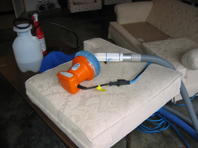

Using an orbital buffer on durable natural fiber fabrics and microfibers saves time and fatigue.
And that little gem in the picture costs less than most horsehair brushes (though the horsehair brush remains my favorite upholstery preconditioning tool by far).
Spend more time with brushes, buffers, towels, sponges, etc and less time with the extraction tool and you'll get better results, with less time, less fatigue, and less wetting of the fabric.

I like a horsehair brush also, but I can see where a small buffer like that might have saved my hand from a little arthritis. :wink:

I use that lil jiggler and it work good. It also vibrates the fat on my fingers. Makes them tingle. :lol:

That wasn't caused by scrubbing furniture, but by rocket polishing :shock:
Funny thing, a while back I posted about using a random orbit buffer on upholstery and got taken to task by some of the cheerleaders now. Funny world....

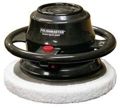

Is that a cotton bonnet on the orbital? How long does it last? Where do you buy them?

I got the terry towel looking ones from Walmart. I dunno how long they last, but seems to be holding up well. They come in a package of 2.

I use John G's pads that I bought when I was going to try encap.
Becareful with the orbital on delicates or anything stretch tight, heavy use or old. It will tear around corners or just completely rip apart where the heavy wear areas are.
