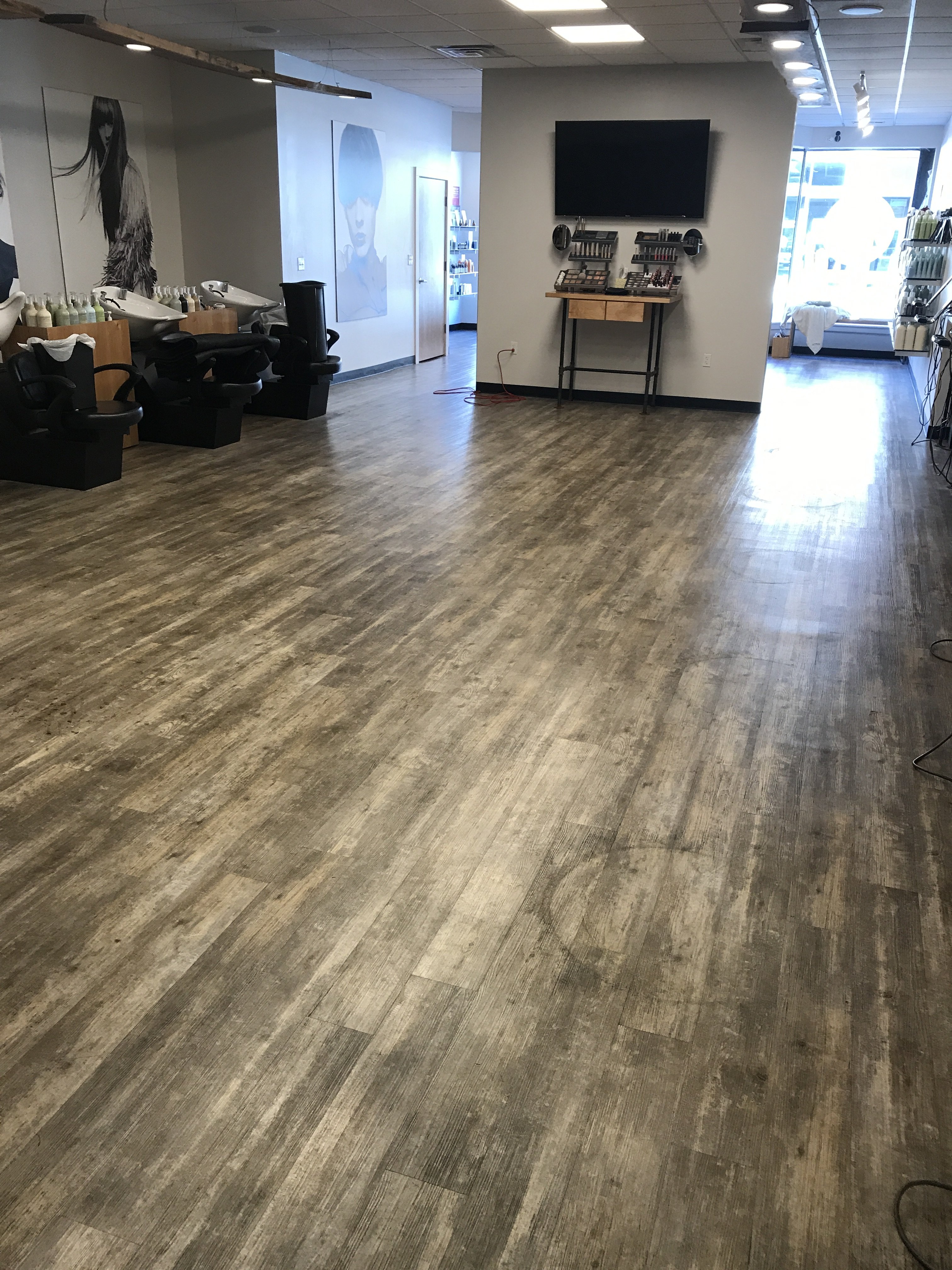

I bid on a 1200 ish ft.² salon today. It’ll probably take a while to scrub with my 10” CRB, before rinsing with the tile spinner. I plan on using Code Red for chemistry.
Is there a brush that might scrub into the grooves in the LVT, that I can get for my 175 or Cimex?
Should I just suck it up with my widdle CRB?
Any other ideas?

I think your 175 would work well with a shampoo brush.
Feb 23, 2017
1,040
Matt Ross
I have jobs with lots of that. Sometimes the crb works alot better than anything else. Just go with the grain. With the right chemical it might come clean with a 175, but that usually requires more moisture than I like using on it. I dont use a spinner on it, but some people do.

Thanks guys! This is a juicy one. It’s absolutely filthy and I think it’ll really pop.
We’ll take our time with the 10” CRB. It’s a pretty sizable salon in a very well traveled area. I really want this to go well.

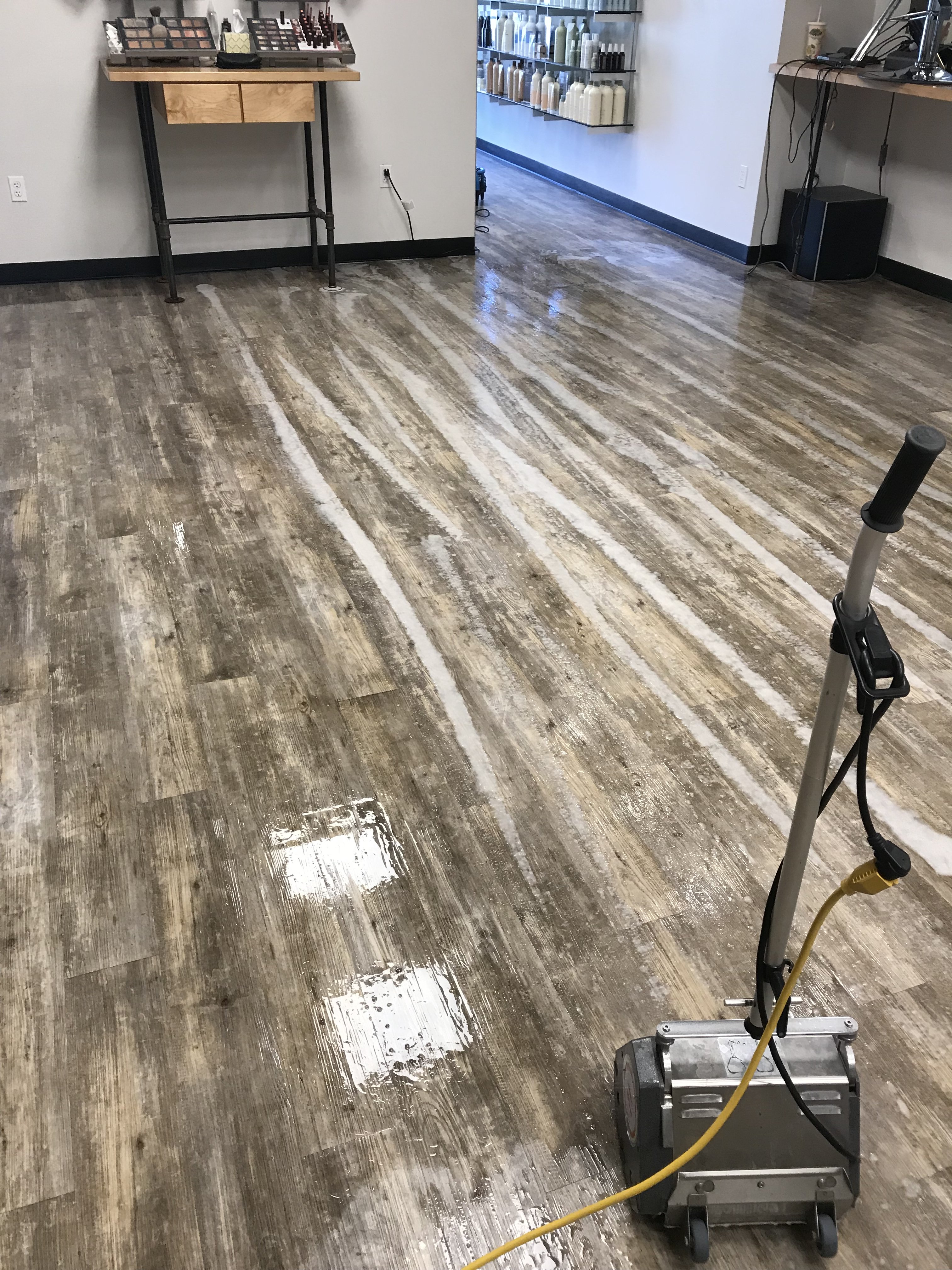

Russ I do a ton of this stuff at my marine base.
Bring a grout poll brush for the edges and where your CRB ( with xstiff brushes) wont reach, mix your stuff strong and youll be amazed.
Glided wand it king
Glided wand it king
You know my Devastator is ready!

These were the only 2 I got. I was alone so I’m always focused on just getting to the other side of a project. Customer was thrilled. It was a cake walk. Took 3.5 hours alone to really make the salon shine again.

Well that was a piece of cake.
I mixed the Code Red heavy in a hot mop bucket and just watched the soil melt off and was scrubbed with the CRB and held in suspension until I rinsed with the Devastator Wand.
Thanks for the tip guys. That was the easiest money I’ve made in prolly a week :biggrin:
