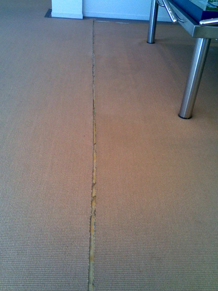

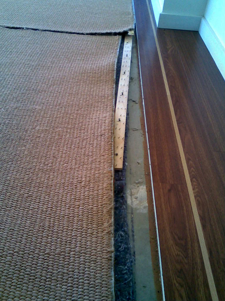

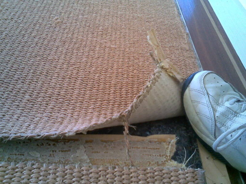

Here are the pictures.
As you can see the seam has been joined together conventionally with seam tape. The problem here is that the underside of the carpet has rubberised backing, hence the heat tape will not function correctly. As you said John, the sisal should have been stuck directly to the concrete.
I walked from this job but am trying to help the boss of the carpet cleaning company by getting as much detail as possible to prove that the installation was incorrect. Any further help on this matter would be greatly appreciated.

Hope you don't mind, but I played around a bit.

In fact, as a carpet inspector, I'd LOVE to get my hands on such a claim!!
Contact Col nation and refer him to the carpet cleaning company and I'd be surprised if his fee wasn't justified, especially if the manufacturers guidelines were not followed as I suspect.

Here is the problem.Latex (coating) . Without this coating the sisal would be a birds nest. Now it should have been glued down. With a 1/8 x 3/16 X 1/18 inch trowel around or simular. This is where someone who does not know installation specs screws up. The reason the coating didnt hold. The natual fiber (Sisal) Shrunk enough to rip apart from its body.You could rub the coating off with your fingers. Anyway it should have been verified type of install prior. When I make area rugs with Sisal I do use seam tape. Or I make a cold seam with latex. That is a bad one It does need to be replaced . Find out the company that installed it to mis specification. Best way to clean that is Host or Encap .

We have seen similar situation in the past which was only resolved with total replacement.

Even if the specs DID allow for a stretch-in, it should have had architectural or double tackless strip.
Only time I've eve seen that kind of shrinkage on a wool carpet was when it was flooded.

That is not a stretch in product. Direct glue or double glue only. Even on a rug they will not waurantee it due to its hydroscopic nature very aclimatical.

Sisal is commonly installed as a stretch-in in the Seattle area, with two differences: It usually isn't advisable to install it in a room wider than 15 feet (the maximum width you can get the stuff) to avoid seams, and the best seam will be sewn and backed by latex/scrim. The carpet pictured is not worth saving, the best fix would be to educate the carpet owner about better options, particularly since the carpet cleaning company will be buying it.
While there may be some issues with the installation, every carpet cleaner should know that if you get sisal wet with HWE it will shrink so fast it will move you across the room. Unless the tech really soaked it, I doubt just prespray caused this much shrinkage.
If it were my case to judge I'd blame the carpet cleaner, 100%, for not knowing any better than to wet clean installed sisal. It doesn't matter that sisal carpet is junk, or the installation wasn't the best. I'd be willing to bet that direct glued sisal will leave the foam backing on the floor as it shrinks too.

IF this specification relates to the carpet in the above pics, it's been laid correctly (and I cannot say I agree with it, but let's stick to facts).
'No cross joins' can't see any.
'Heat bond tape to be used' evident
'Architectural smoothedge' also evident
'Jute or jute/hair combo underlay (padding for you guys)' a reconstituted fibre underlay has been used on this install, which has similar, if not superior property's to jute (alone) underlay.
So IF this sisal carpet (sic) is supplied with the installation specs below, the layer did the job correctly (and I'm having trouble saying that)
It would be an interesting case if it went to court

N.B. For the best possible results, we recommend that all natural fibre carpets are
installed using architectural smoothedge and put on a 7lb 100% Jute, Jute/Hair
combination commercial underfelt or Bridgestone Cushion Pad.

Well, stated Micheal.
Did you see the force it had on pulling the tack strip off the the concrete, It looks more than just a prespray. I have wet cleand sisal before, but you have to be very careful and use a brown- out after cleaning.
Deron
