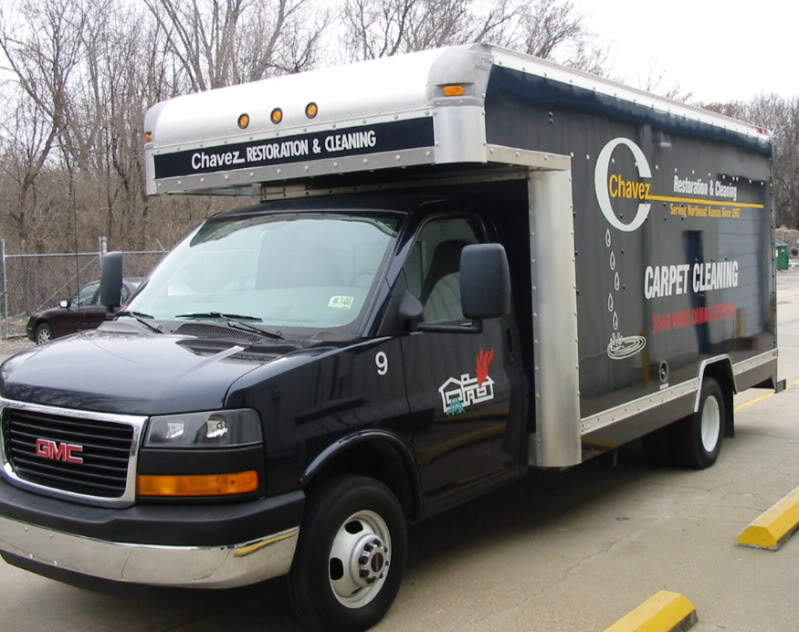

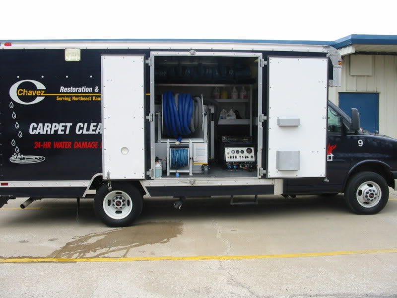

Here is ours.

Nice unit....ChAvEy.. :!:
can you please BE,,,"Doc Holliday"....this week.. :?:
It fits your character ...MUCH BETTER than...TOM... :wink:

rich it`s a nice set up.
is it true every 40 min. your truck is running it`s like driveing 25 miles?
