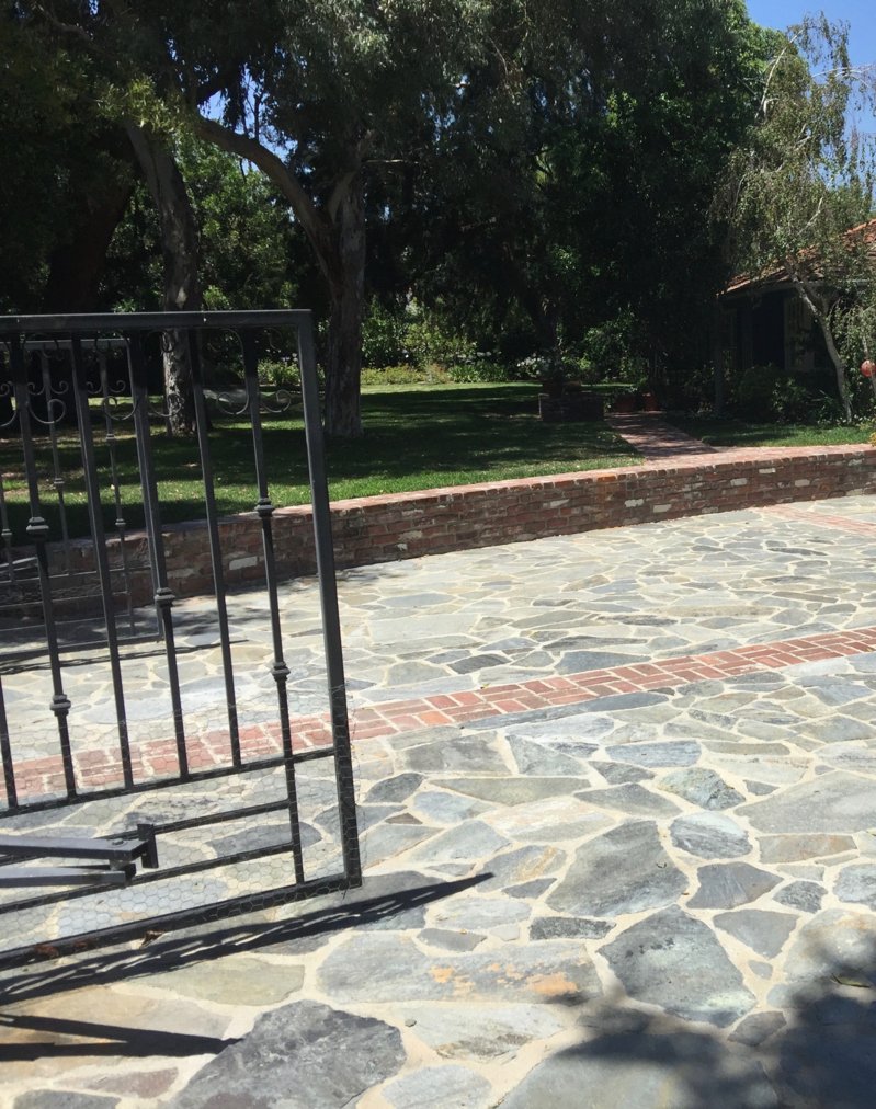

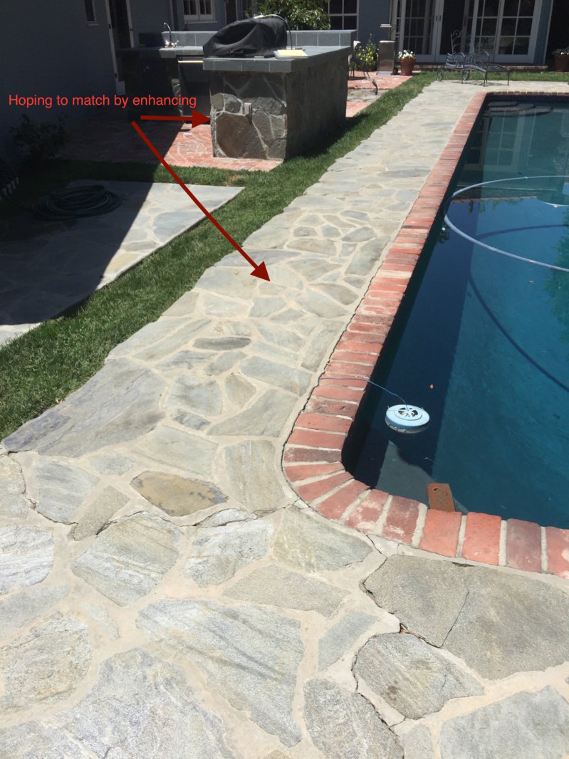

Any feedback on longevity before CEX 100 starts to fade outdoors?
http://www.easystonecare.com/CEX-100-Enhancing-Sealer-p/cex100.htm
3000 sqft thats going to get lots of sun, sprinkler overspray etc..

I don't know honestly. As far as overspray and other film or residue, CEX is an incredible sealer and will make maintenance much easier. It will definitely bring that color out a lot, but as far as lifespan in direct UV, I can't honestly say. It's up there with the better ones, I would expect a couple years out of it at least.
I do have someone in FL. that uses/used it on an exterior job. I'll check with him and see how it's doing.
At that price point though, considering you can get 2-4 quarts out of it, depending on the stone, it is by far the best bang for your buck on the market. I wouldn't consider it an economy enhancer, it is very good quality.
