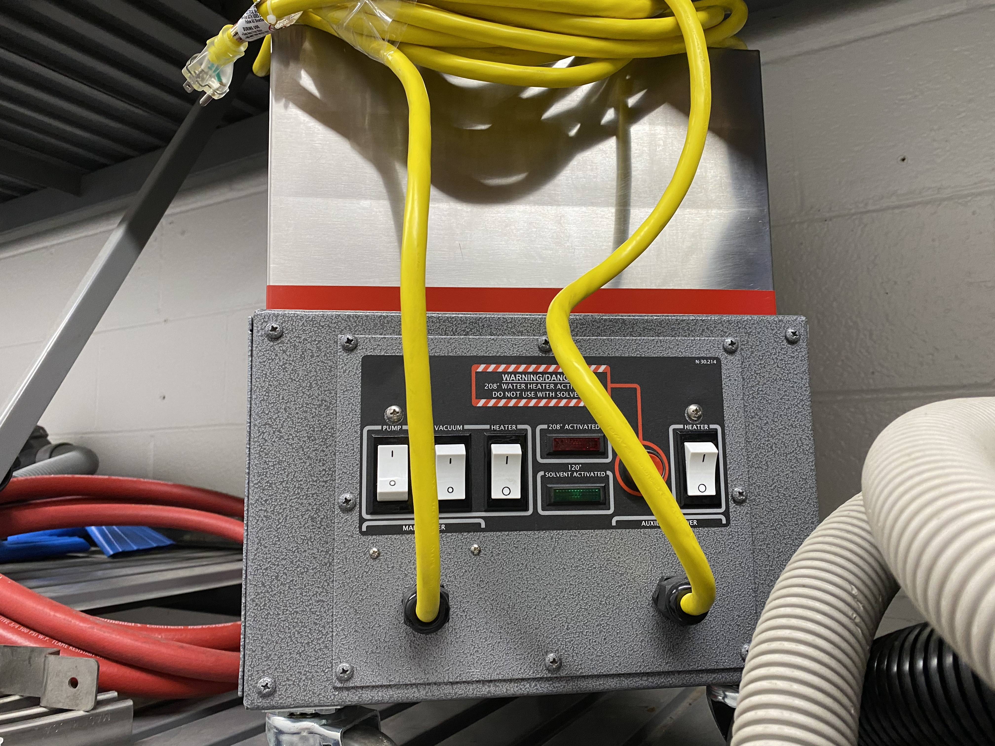

Wondering if Drimaster tool can withstand solvent dry cleaners or is there another upholstery tool that can withstand solvent dry cleaners.

As a safety feature.if you use a us products or klernritr.
Remove heater fuse.
So as to not inadvertently turn on a heat solvent.
Whilst distracted or performing the service work.
Stay safe an profit.

Most solvent will swell the orings. Also, the nature of how the tool works will use up a lot of solvent.
If you really need to dry clean something, mist it with the solvent and wipe it off with a microfiber cloth, or use an orbital buffer with the microfiber cloth.
Drawing solvent fumes through an extractor invites fire or explosion with a portable, or expensive to legally dispose of waste in your truck mount.
