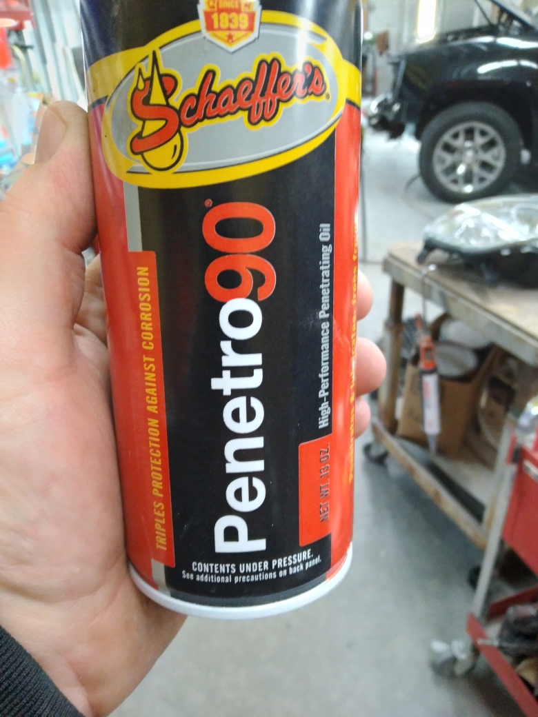

Lobe rub....clean with warm water only...
Run a min or two
Followed by a short burst of
