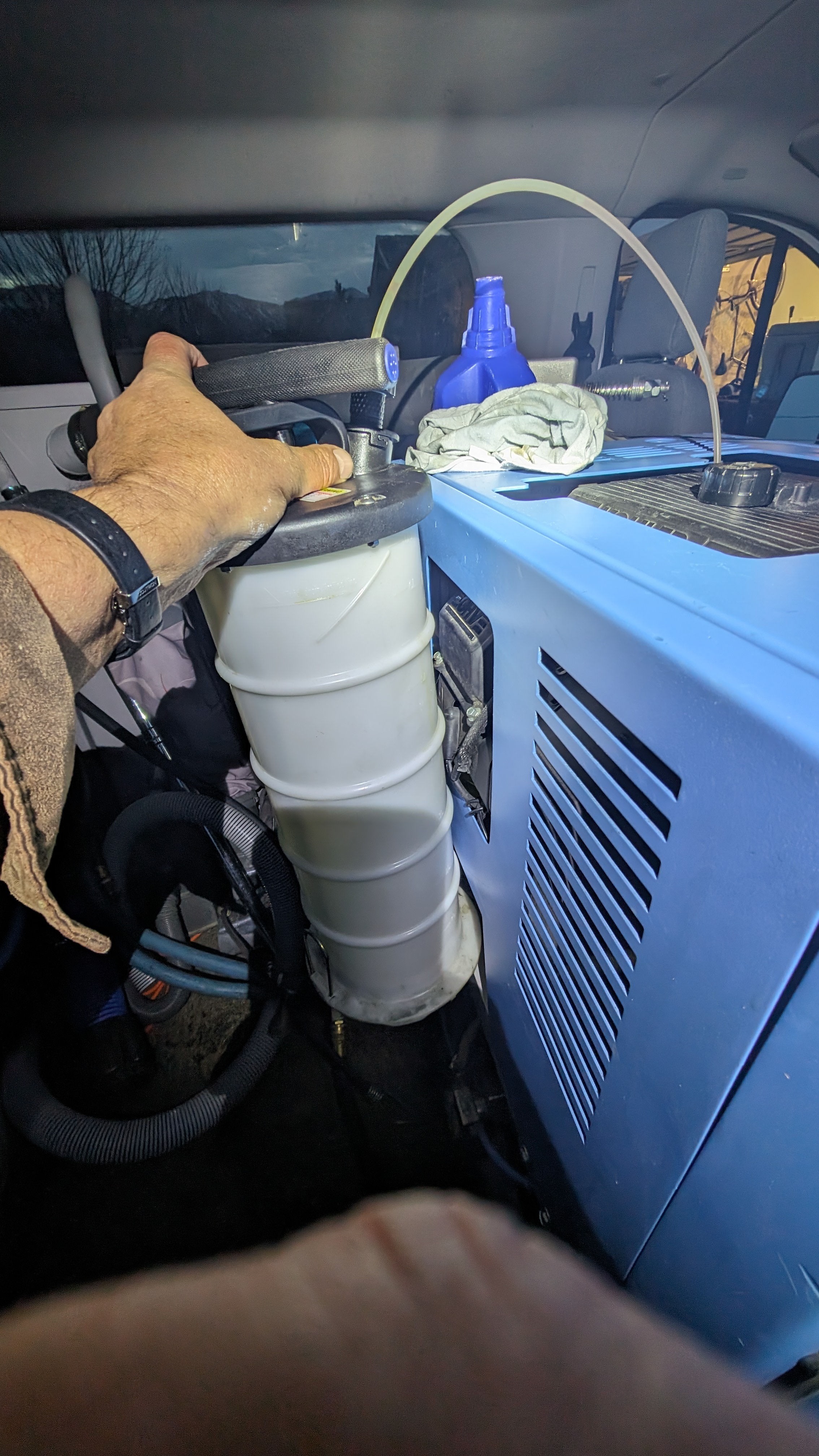

This is a 2013 Legend GT #4 Sutorbilt blower.
The manual says both water pump and Vac Blower have a 14oz capacity.
Maybe that's why I'm right above 1/2mark on site glass using 6oz?
I'll call the JonDon mechanic I know Tuesday as this oil is vulnerable to overheating if too much.
We did use an air compressed tool to help remove as much as possible and I believe the TM mechanics would do no different. I'm not running this at load or on a job yet& If I do this over again to clear doubt I should probably park on a hill like I do when I change engine oil 🤔

Also manual: "
"Vacuum oil capacity is 14oz at gear end."

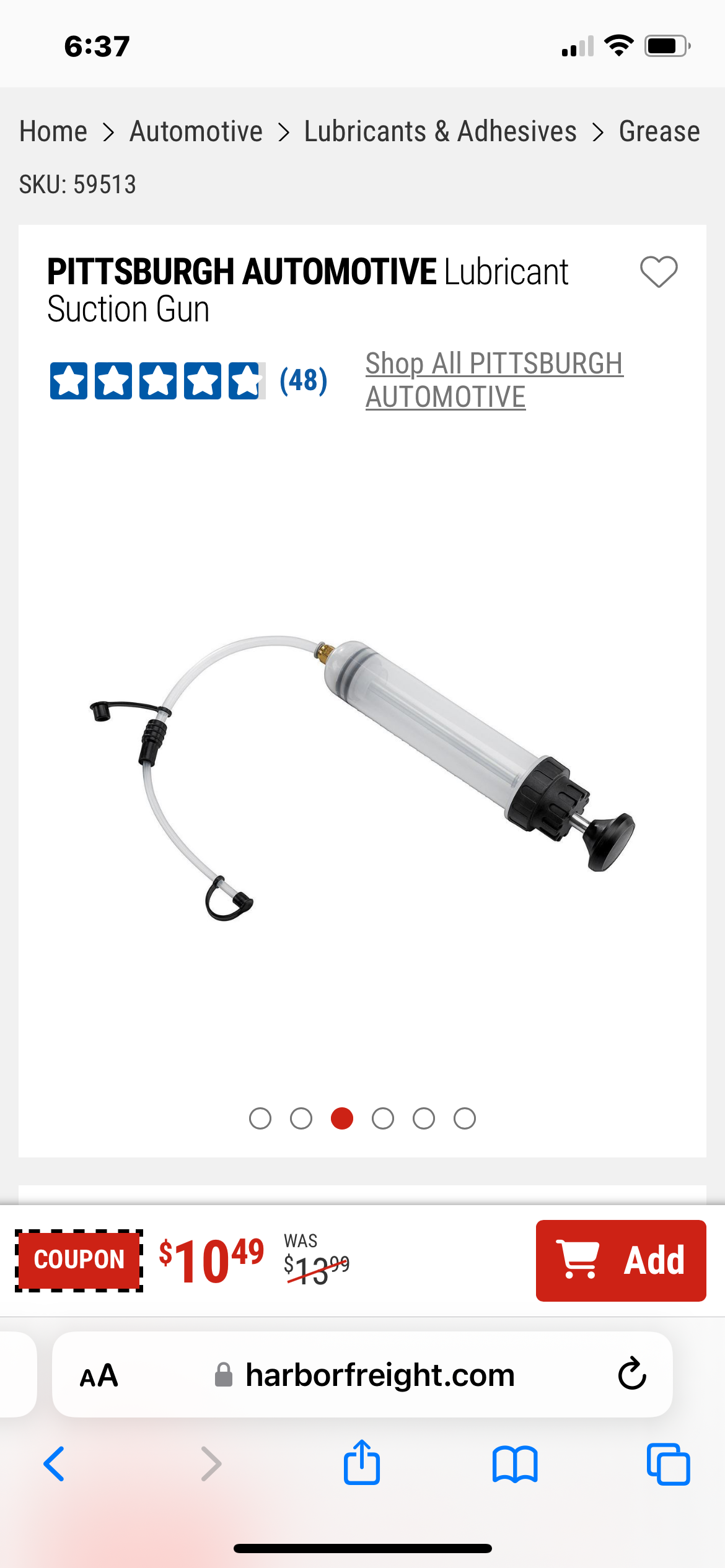

The exchange rate here of old Aeon oil vs New Aeon oil doesn't inspire confidence. Here we are as glorified vac cleaners and there's no vac attachment to extract...
