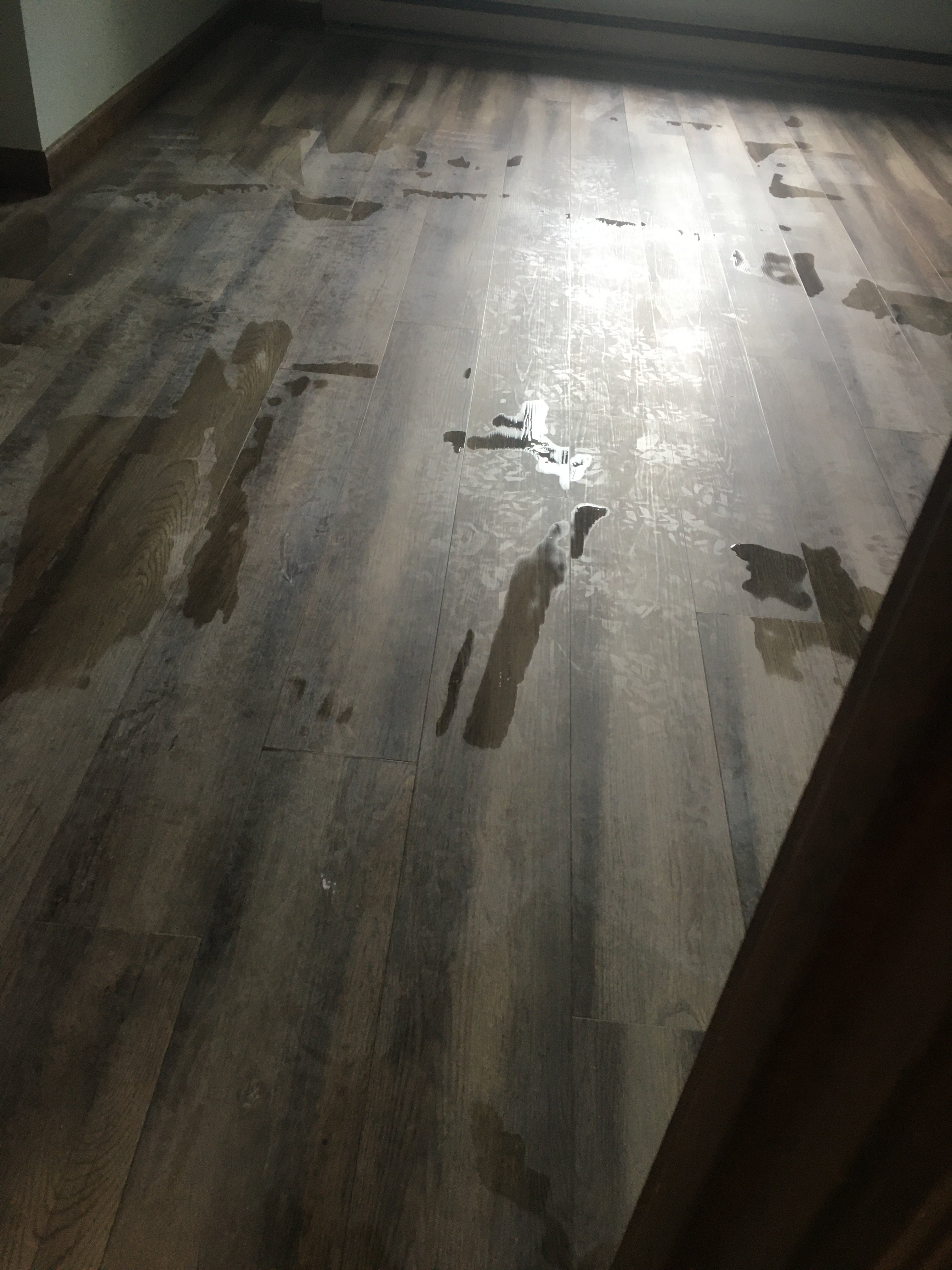

Which neutral cleaner do you guys prefer to mop or spray on it prior to rinsing?
14,096
I went too hot with a ph when I was cleaning this and the footprints were hard to remove. I think the high ph had something to do with it
  • Wow
Reactions: SamIam and Mikey P
14,096
I did a rinse flat mop with a 2-3ph rinse and it didn't budge. The reason I was cleaning it was Sheetrock mud from construction. I've learned to use a lower ph formula, but I still get paranoid on these floors. It think there's a shitty finish that comes on the surface
I really don't like cleaning this type of floor.
