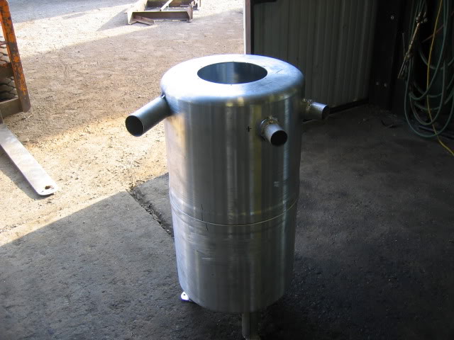

yes it does come with a waste tank the one in my van is a modified prochem tank which I welded a new bottom on and new powder coat, I have not finished my new tank for this machine yet and it will look like this one

How big a tank is that? Will it need to be anchored to the wall or will the feet be enough to hold it when filled with waste water. Can you cook chili in there too? :p
