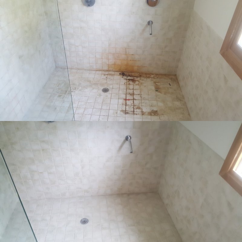

We do lots and lots of showers. They can vary a lot but just the cleaning side isnt that complicated.
Usually we start with a high pH pre treat, most of the time no grout line scrubbing is needed because the chem does all the work. Stainless grout brush if you have some really tough areas.
1000psi, high heat (even though not always needed), cobra hand tool or hand spinner. Sometimes youll need razor blades for really nasty spots etc.
if the shower is kinda nasty many times youll need to replace the caulking with something, color rite makes nice products.
