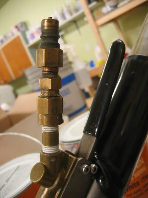

Are one of these pieces supposed to be a filter?
The piece next to the qd is stamped "spraying systems co." inside it is a part that can be turned with a blade screwdriver?
The next piece seems to be a reducer nothing inside it. Stamped 4676 1/4 max 1500psi.
Anybody know what these are?

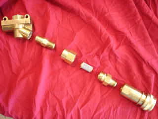

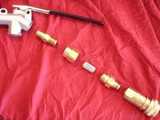

the strainer is inside the piece the QD is on.
that part you saw that looked like it "turned with a screwdriver" is the strainer.
The screw driver slot you saw is for the check valve internals in the strainer.
You don't need to monkey with that to pull the strainer.
The whole strainer assy simpley pulls out.
you might have to gentlely pry a bit to remove it though.

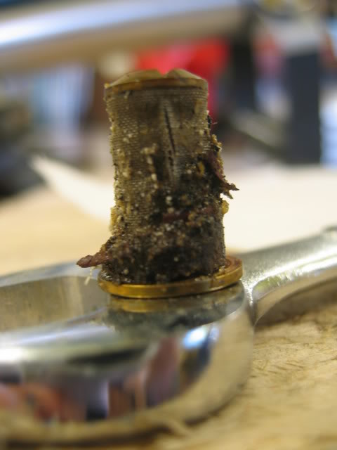

cause my guess is, it's packed with silt/crud.
Other wise it would drop right out.
pull the strainer, clean it, then inspect it closely.
I'd bet a nickel the screen is blown thru some where.

Thanks for the picture Jeff, its starting to make sense now. Heading to the hose & bearing shop tomorrow to see if they have any strainers.

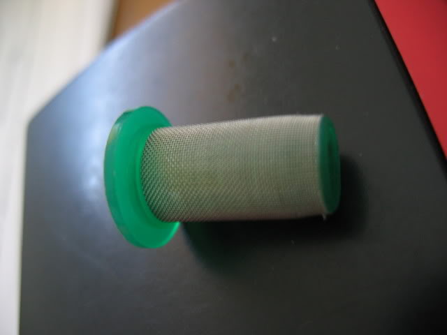

Found these at Nicks farm implements are they good enough?
I don't know if the plastic will hold up to TM heat and psi, Jim
thats what you need, only brass body instead of plastic
I'd use that plastic one til you can find one w/brass body
most carpet cleaning suppliers/distys will have them.
generally they're expensive at suppliers though
my local farm supply carries them in plastic and brass with and w/o check valves

After reading the above posts I scavenged the strainer off a barely used PC quad jet. Ti ran like a chump all morning, nice to have that rectified. It's better to be cleaning carpet than jets!
Greenie, does seem a little pointless thanks for pointing that out. Will get a couple extra metal strainers and leave the plastic ones on the shelf for now.
