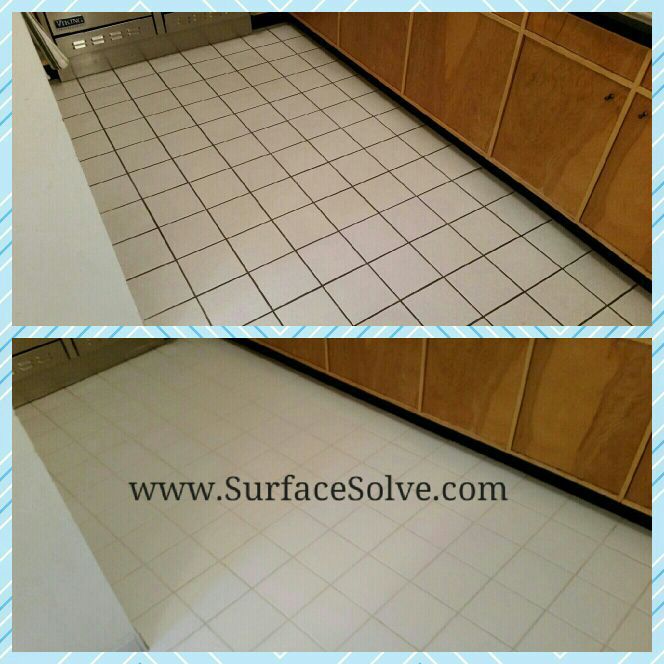

I finally got around to ordering some of this last week. Got it in just in time to try it out on a white commercial kitchen tile and grout.
Very impressed.
The shipping charges are a PIA, but if it keeps working this good then no problem.
This was cleaned first with power burst and a degreaser. Machine scrubbed, then turbo @ 1500 psi. Some left over staining. Mopped on at 5 parts water 1 part acid. Scrubbed trouble areas but hand and let sit for 25 mins.
Probably one of the most impressive differences we have ever done.

It will look even better when it's really dry.
