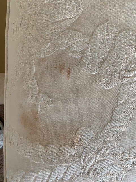

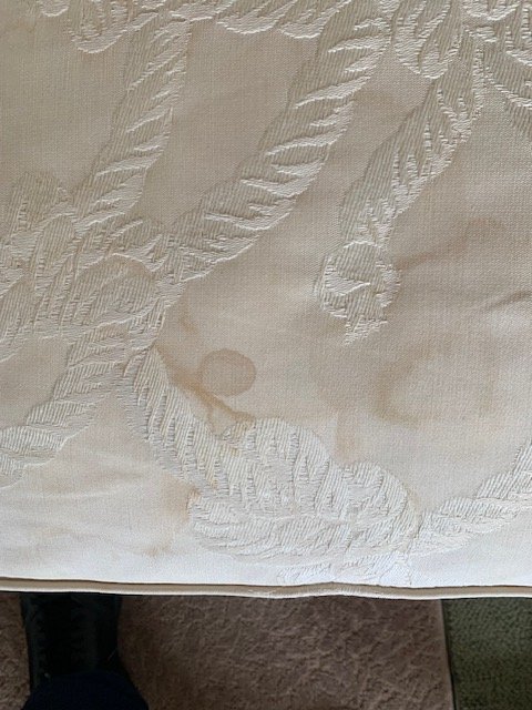

coffee on sofa
sassyotto
Jun 7, 2013
1,328
Paul
two sofas. tons of coffee spills.
Any suggestions?
28,270
Reactions: hogjowl
28,270
applied Stain 1 prior to cleaning, 2 hours later no change.
May be decaffeinated coffee in which case a reducer would work better. Something like Red Vanish. It can work too well, stripping out the original color. The oxy-encap works well normally on coffee as the buffing action provides a gentle scrub. The oxy stays on until it evaporates off, working until it does.
