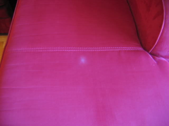

I attempted a spot removal on a polyester sofa recently. No pre test. Used a vds and no problem spot came out but removed color also. Is there anything that can be done to rectify this?

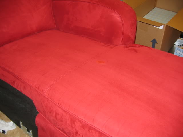

Don't feel bad Jim. Take a look at these 2 chairs that Bill the cleaner um "cleaned". Actually they look better in white but the gold color is how the chairs used to look before......... well lets not go there.
This is also what can happen to your hair from drinking too much coffee or spending too much time out in the sun bike riding.

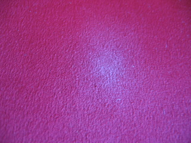

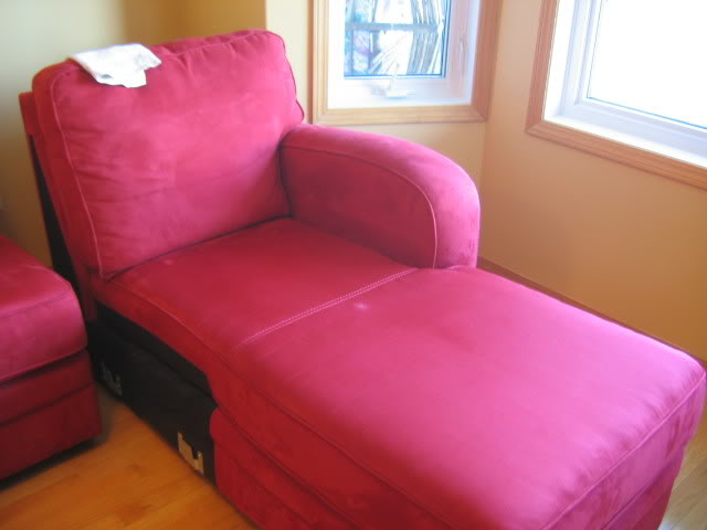

Did a burn test, all I can tell is that it is synthetic burns down to hard ball and has a white cotton backing. Found a marker pen that I thought was close and depending on light and lay of the nap looks not so good:
or not so bad:
Will return piece to customer and see what they say. Thanks for all the help
