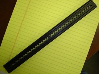

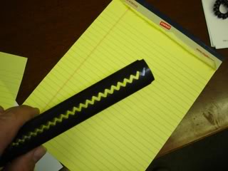

Rookie, is this one of yours?
I assume it was for agitation, I nicknamed it the sharky.
Fits a Prochem quad jet wand is why I thought it might be yours, plus I know how much machinst love delrin.

And no Jeff that's not mine! :lol: But looks like it could grate cheese pretty good!
:lol:
