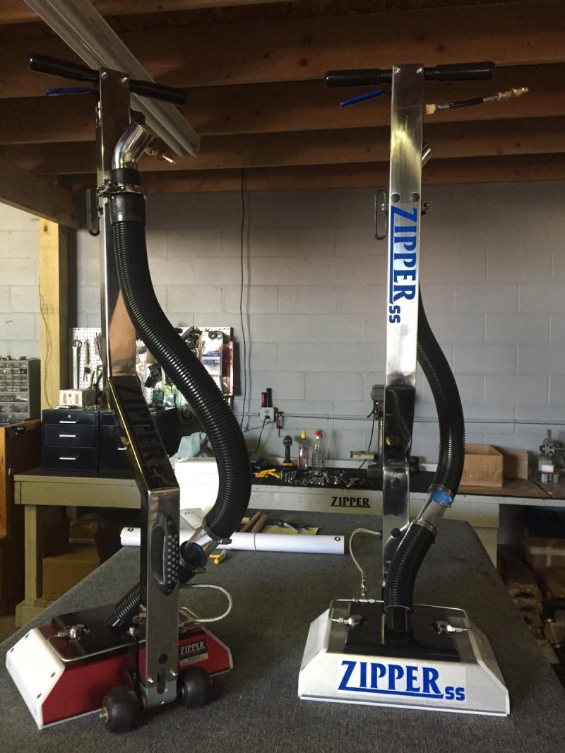

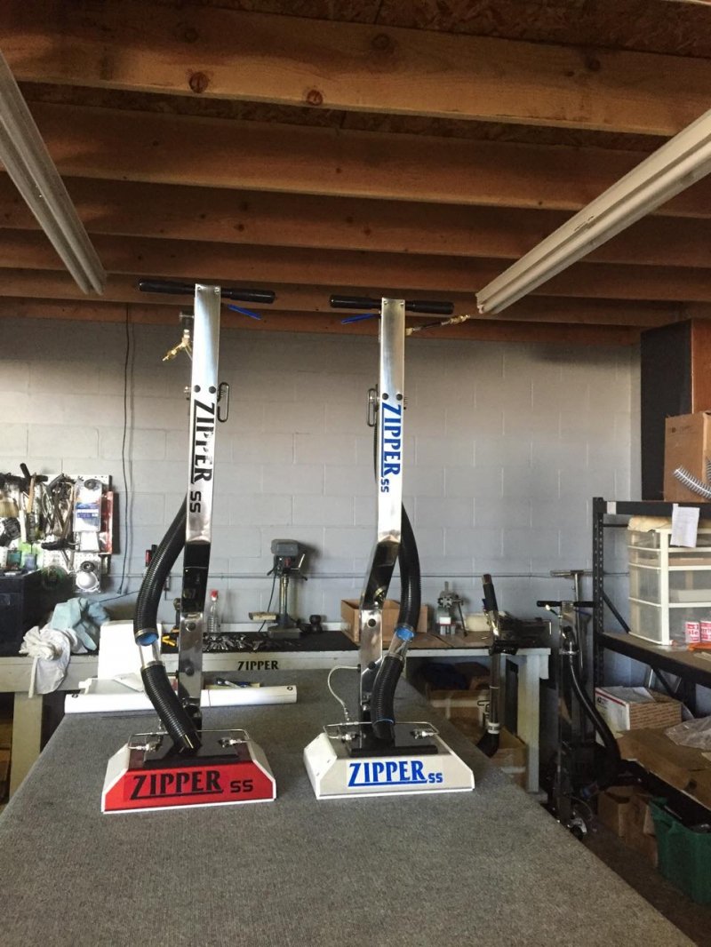

Check out the pictures in the original post. Something changed somewhere along the line. This doesnt look like concrete floor to me :)
