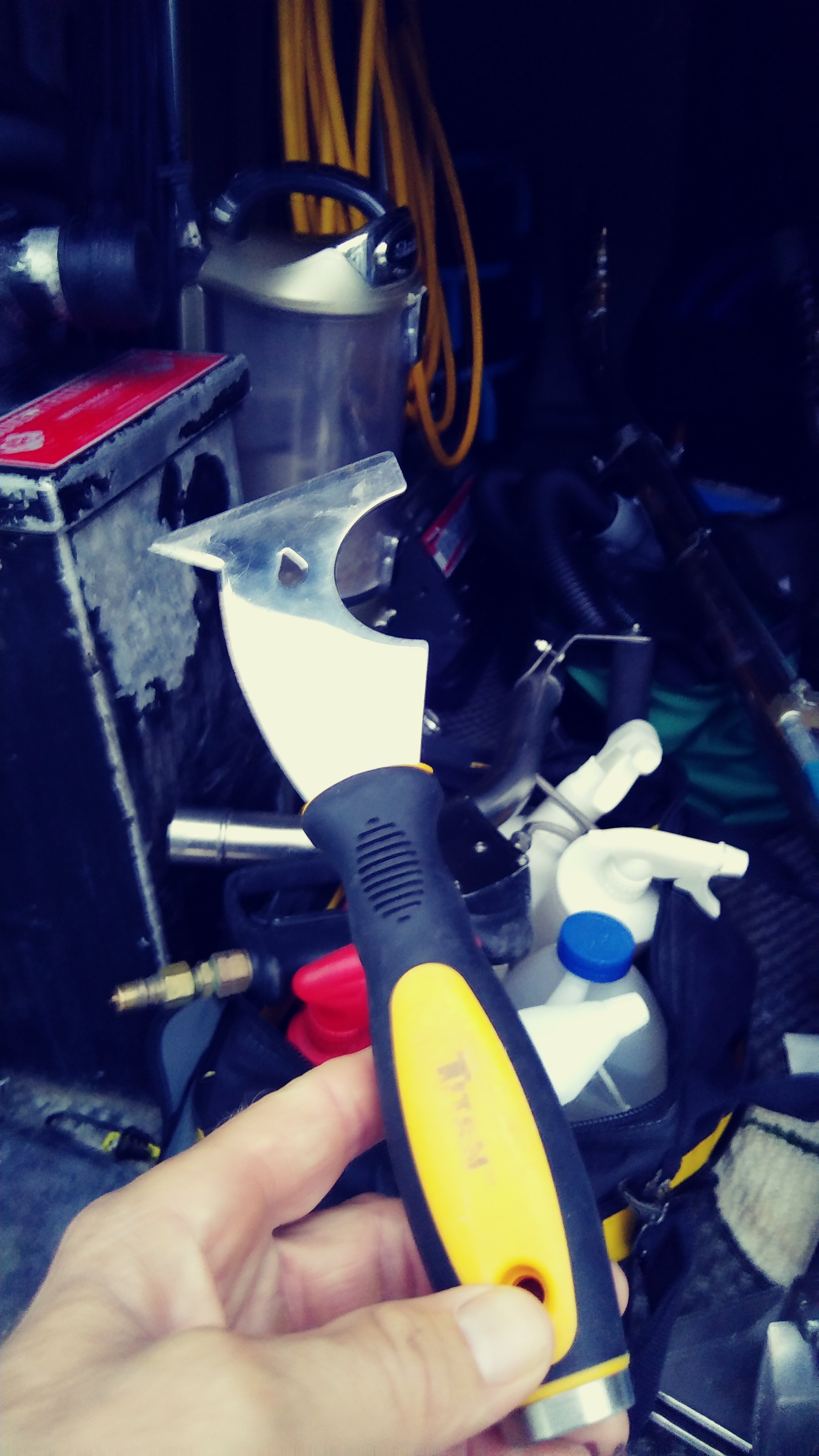

You can get a filter for the exhaust too but I found that blows the air in different directions causing settling issues. Blowing 2 feet over the ground doesn't stir it up much.
And a sharp one of these.
