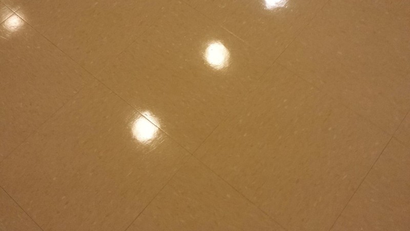

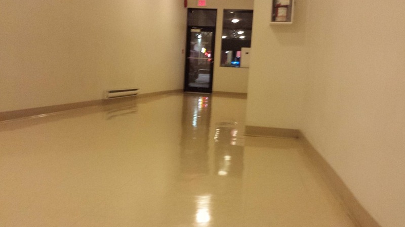

Vancouver
2100 SF @ 1 a square. Mall offices. 5 coats, two 7 hour nights. Doodlebug and scraped edges. It was a mess with top coats over filth,but the dough was good. Don 't do a pile. I hate and I MEAN HATE!!! night work. Most won't pay me what I want either. Don't care.
Vancouver
Looks great!
How many guy's and how many offices did you do?
1 other guy 3 part offices -the rest was carpeted, and all common areas. I get a monthly wash and buff for common areas for another $175 :smile:. Takes a little over an hour. I just stuck a $1500 cheque in the bank for a 3000 sf clean and top coat at a school. 12 hours, 2 guys, they supplied the finish. They strip and refinish yearly and clean and top coat twice a year. I'd still rather clean carpet, but positive cash flow is positive cash flow. My work doesn't turn out too bad for a self taught guy.

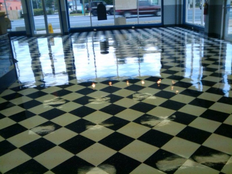

One of many. I do these alone because cleaning up after others becomes counter productive.
Vancouver
Yes that's master status. Love to know what products you use. Were those new tiles or did you restore them?
