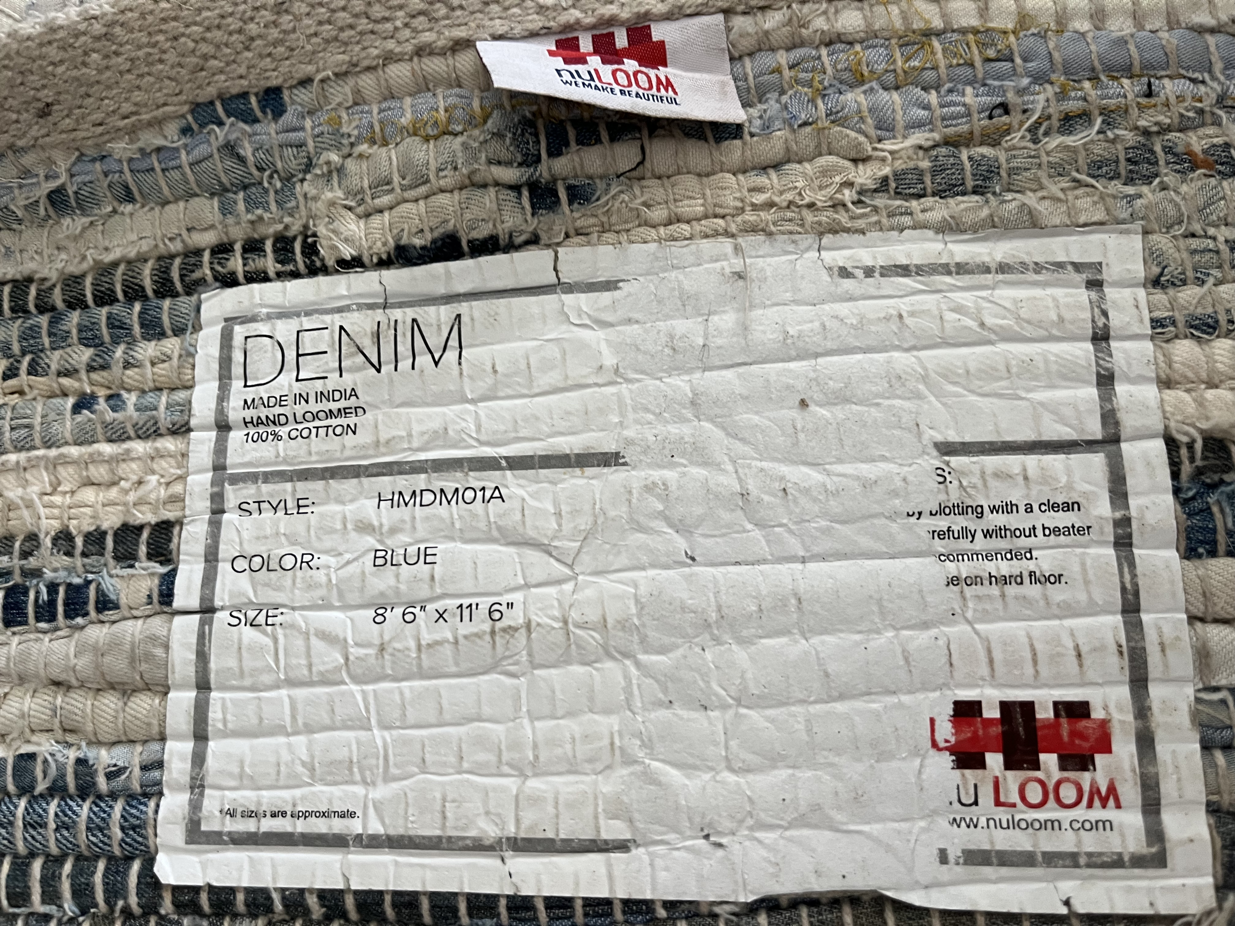

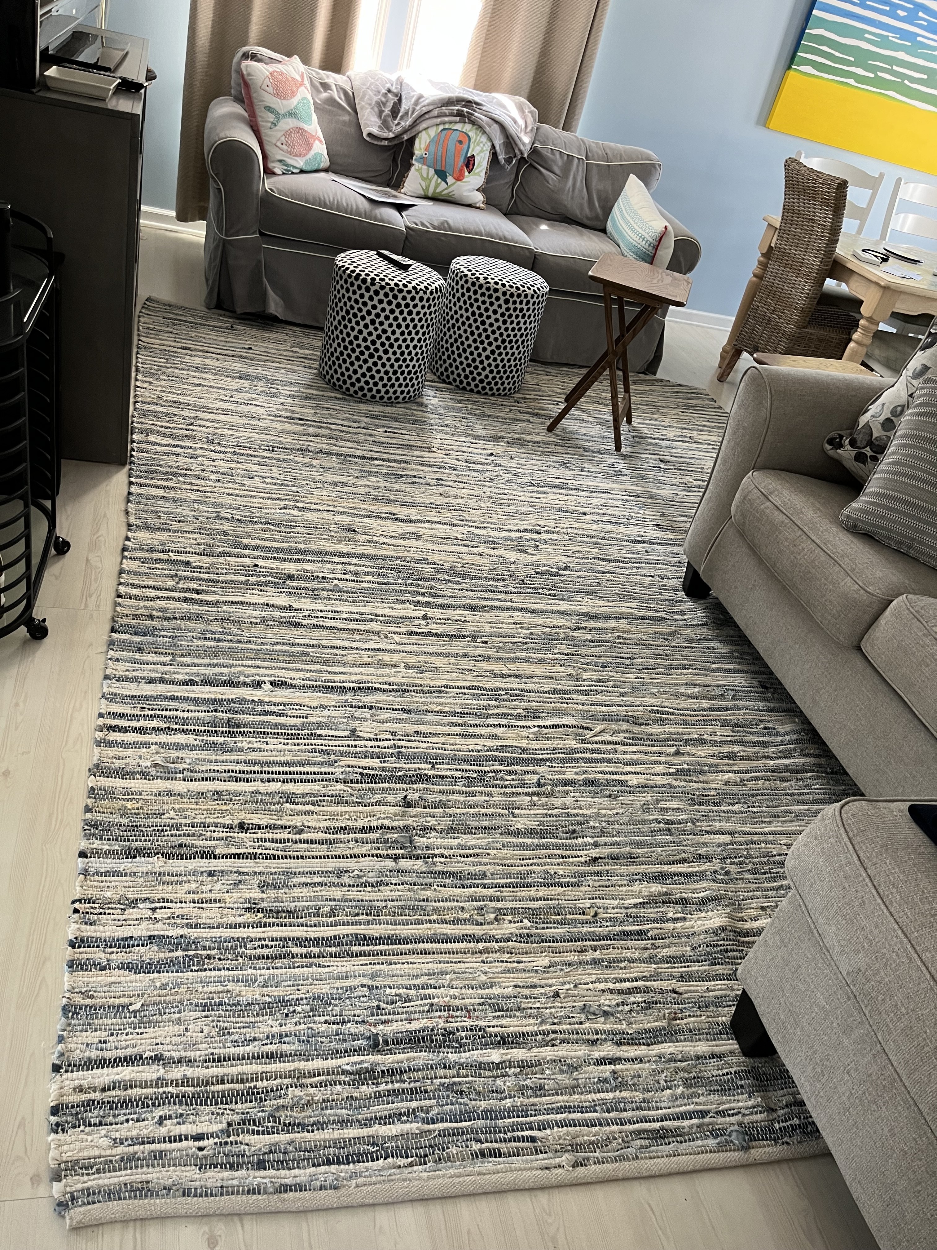

Got a pic of an area rug from a new potential customer.
Not used to doing this by picture, I usually like to see it in person, but incorporated this pic thing recently.
Would y0u schedule this for an in house cleaning? Im thinking $125, easy.

Browning is in your future if you HWE that with a wand
115,920
It would be highly entertaining if you cleaned THAT! with TOPSPOT...
This is one if those situations where 1.0 would say " if you have to ask, DON'T TOUCH IT"
3.0 says find a real rug shop and pay real close attention to the rug portion of our class in 2.5 weeks....

Cleaning in shop HWE is best bet, after letting customer know the colors may bleed a little.
Reactions: Mike J
9,552
Hawaii
Denim on upholstery or rugs is not the smartest thing to purchase.. You can clean it, but I wouldn't attempt on-location..
It will get lighter and possibly move the darker colors to the lighter colors..

I replied with the risks mentioned, recommended rug washer, and not on site. Told her for $125 I would give it a cleaning after October, probably in the winter if she didnt care and just wanted to try knowing the risks. Pick up and drop off. Easier than digging clams.
