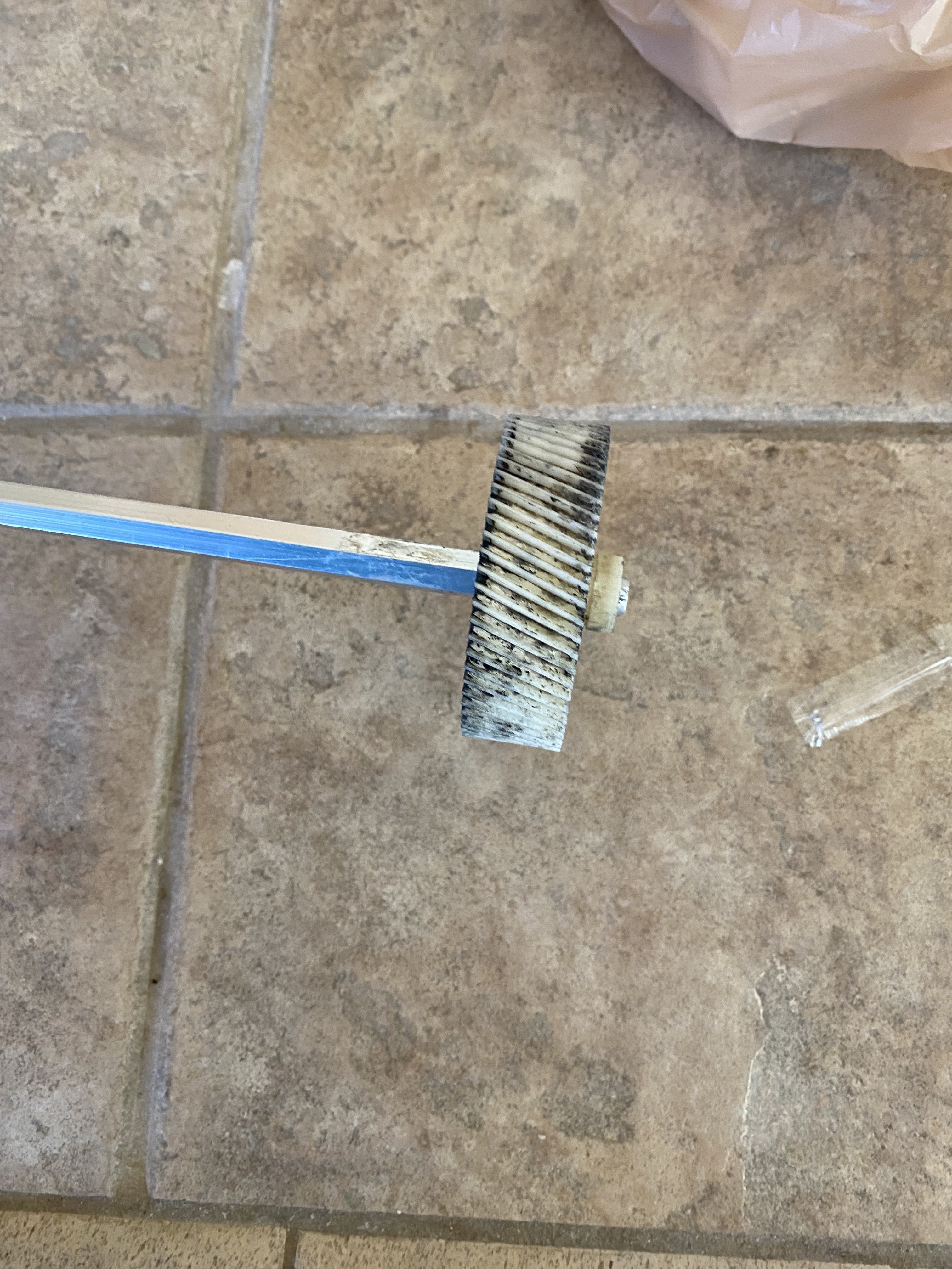

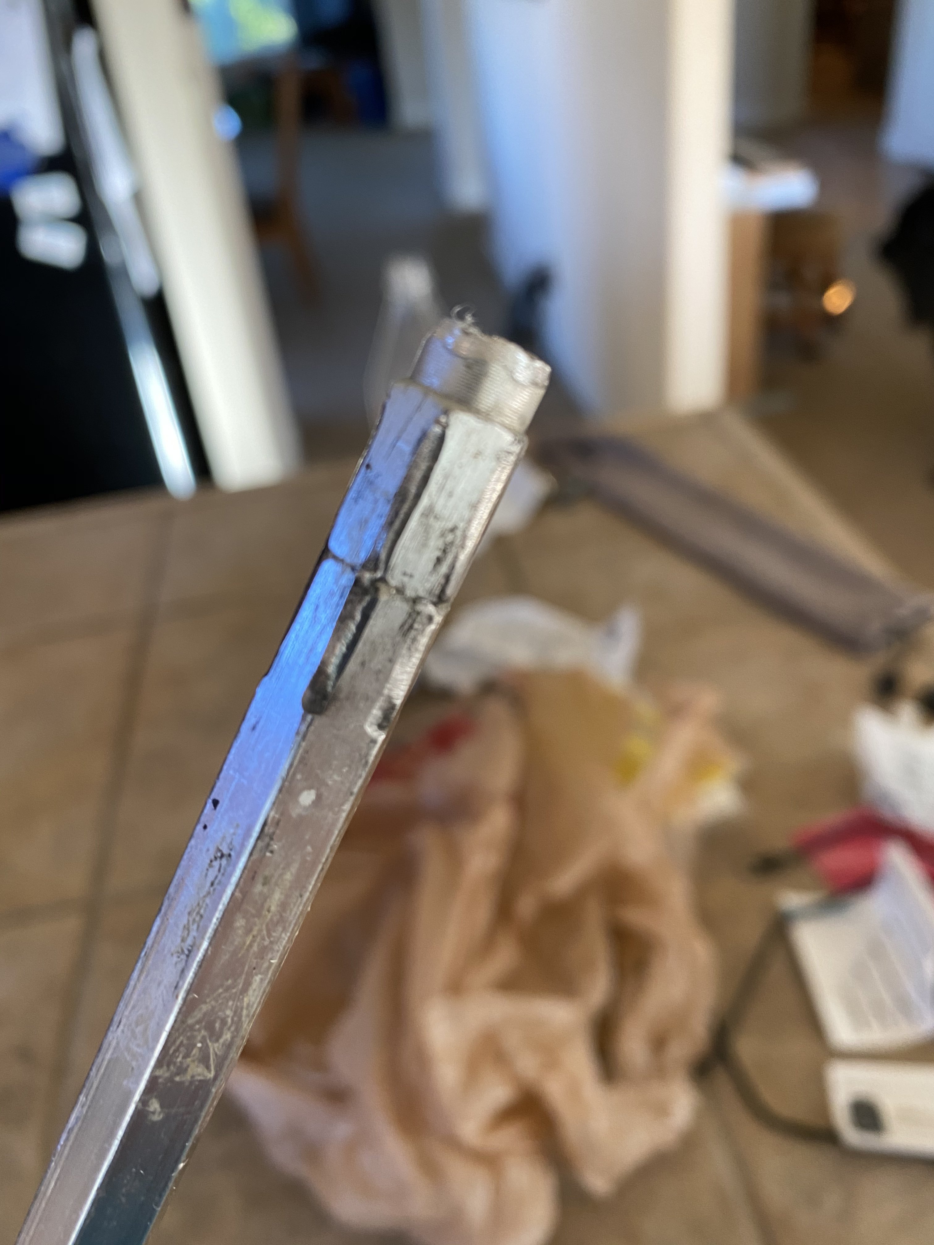

One of my brushes stopped turning yesterday. I Figured I stripped out a gear. Took it all apart and looked at the gears and everything looked good. Then I noticed the shaft that goes through the roller. You can see in the pic the shaft end is worn down to the point where it was free spinning inside the gear. Anyone know where I can order just the aluminum shaft?

Found the part, Cost me $53 with shipping. I don't have time to shop around, so I got it. Also, check out this new thing I just saw. A corner cleaner for CRB's

Got my new CRB part installed. I must have got lucky and ordered from a quality crb dealer because the new part was built much better than the original part that broke. The new axle was made out of steel rather than aluminum. The spring bearings were better quality and the axle itself was much heavier. The part fit perfectly on my Sure Dry copy of the other kind. My gears still looked good so I cleaned them up and applied new grease.

Sorry, I didn't take a pic of the new part. I just wanted to get it done. Just know it is of much better quality.

After some of us had issues with the bearings going out so fast they started using better bearings. Probable went to stainless and a marine grade I would imagine. I haven't any issues since mine was repaired.
