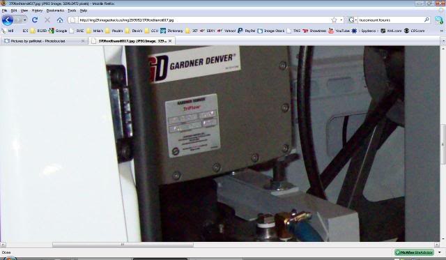

its a Gardner Denver (Sutorbuilt) 406 trilobe plumbed 2.5 all the way. Yes we will have it plus a 3rd model in the line with more performance,

Hey Bill,
I was looking at the 327 at a local supplier. I had noticed that the belt from the engine to the cat pump wasn't aligned straight. I wasn't sure if the alignment was meant to be that way per the design of the machine. Just wanted to bring it to your attention.

I asked hm what distributor he saw the machine at in the PM because we like to discuss this type of situation with them first to get all the details. Its just the way we like to do business out of respect for our distributor partners.
But since you asked I told him that what he saw was not something to be concerned about because the pump only uses about 2.2 horsepower at maximum PSI so belt tension and precision alignment isn't a requirement due to the lack of torsional pressure being applied. That being said we have added a indexing point to the the fram and pump mount to make adjusting this a simple procedure should someone need to do so.

It isn't out of alignment (at least not anymore) Stephen sometimes you need to ask the right person before posting something and besides you have been in the store and know it was already addressed.
And if anyone wants to know they drove up from AZ that same day to check it out. They have addressed the issue with the builders on the assymbly line and am confident they won't have another leave the plant that way.
