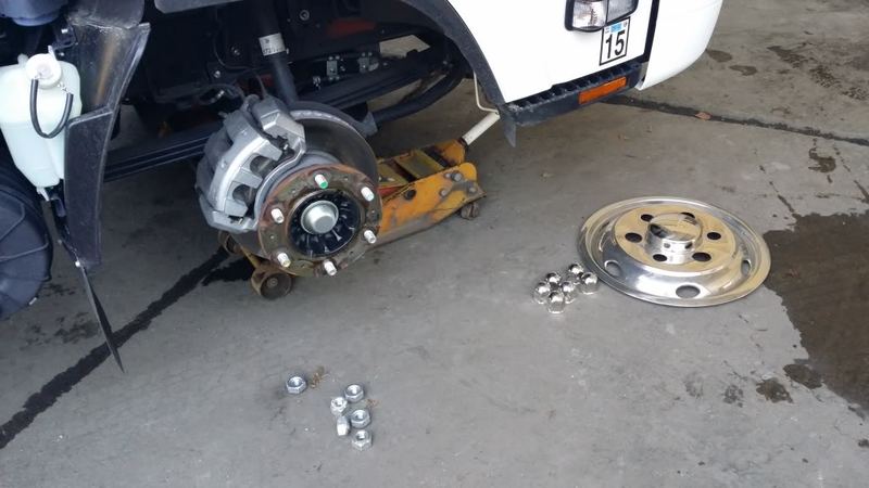

This local place where we buy all our tires only charged me $25 to rotate (and clean the simulators)... 3 guys, 40 minutes.. Nice Service!
Great company
These Simulators blow away the cheap ass Ebay special I have on the V. No clickity klacity clips to hold them on... real lug nuts under those covers..

My simulator clicks clack. Got them from the same place as Jim. I would of spent more not to put up with it.

Its how they put them on..they have to be centered...its not where you buy them its how they are installed......if they are off a bit they are out of round and hit the rim.......
when I put mine on the old UD they were clanging all over the place....I reset them and never had any more problems.......
you also have to make sure the lug covers are on tight against it......only 3 lug nuts hold them on........

I was pretty careful to center them because I'm anal. The one that's the worst I had to force on. One hole was 1/32 off. He sent me a new one but I haven't pulled the old one yet. I'm not to sure how you get the lug covers off without scratching them. Mine took a mallet to get on.
