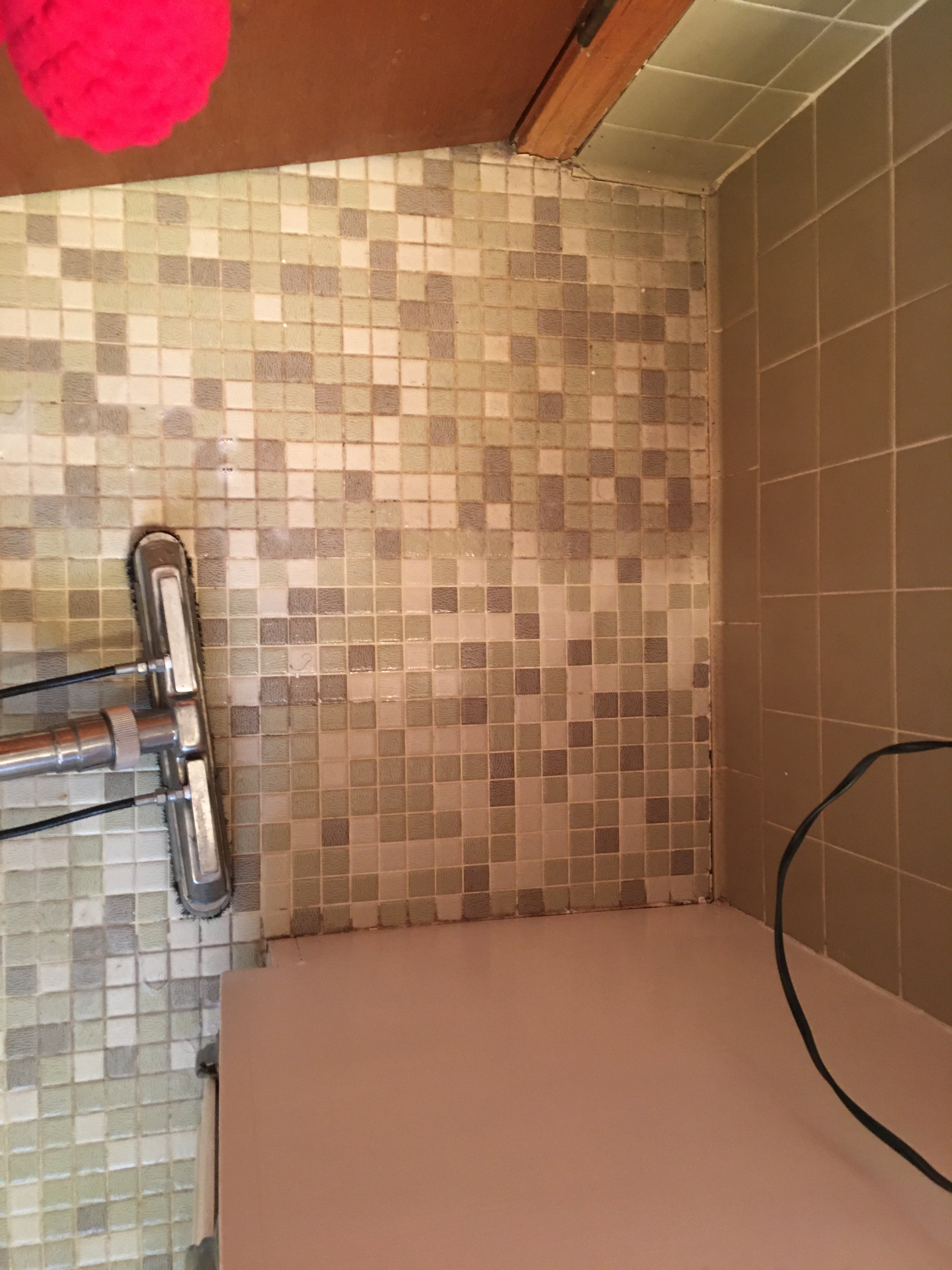

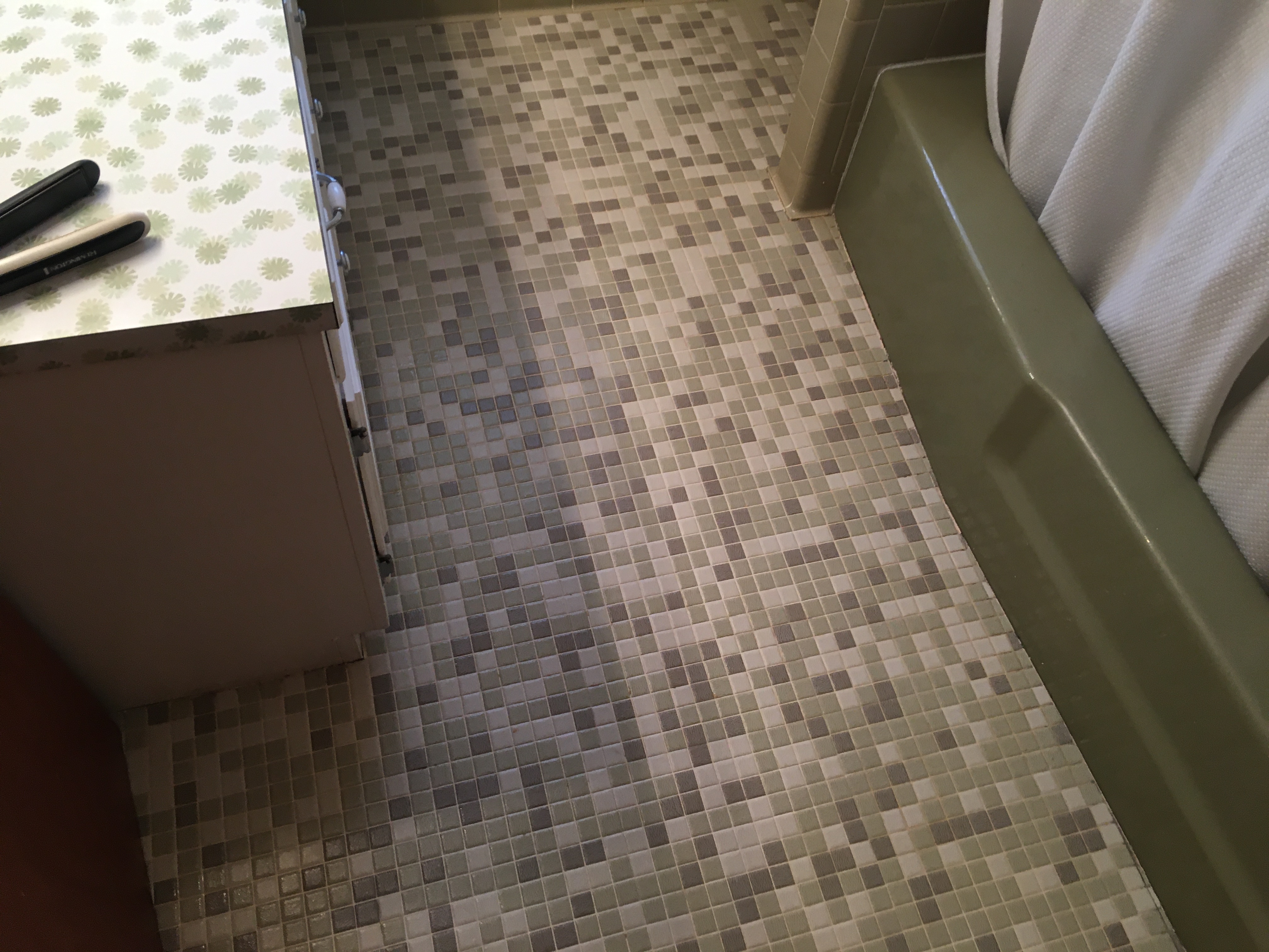

14,107
I used just that acid rinse to treat this tile yesterday
That grout looked brand new after. No agitating or any alkaline Prespray.
4A41EA17-C5D6-4B36-B1AB-546340DB7169.jpeg C469D146-ED5B-4016-B3D5-EA66BED8CDC4.jpeg
