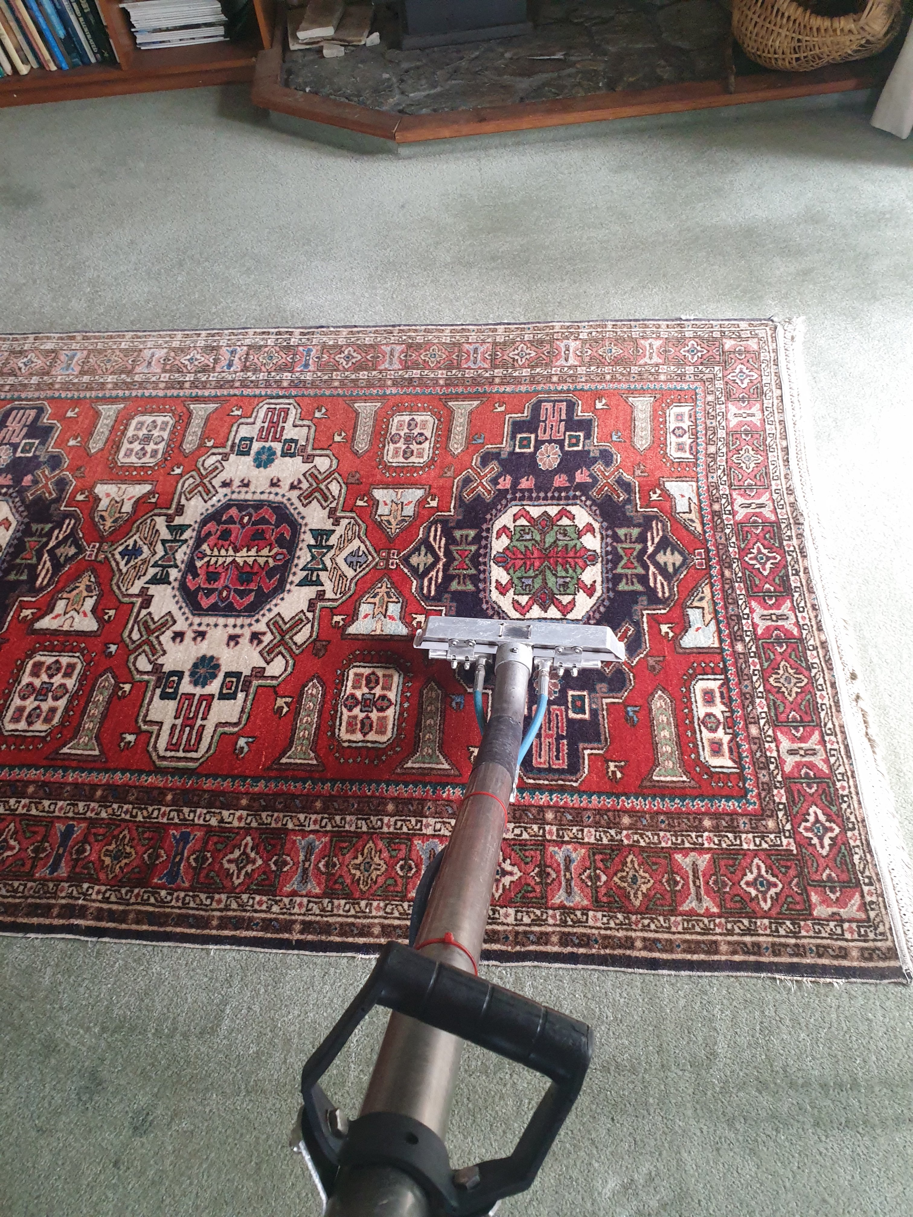

I clean them and always have - in the home.
Cleaning methods vary. Regular wanding, dry compound, upholstery dry type tool...whatever it takes. Chemistry will obviously vary as well.
I know I'm not an "Expert" but I have cleaned hundreds over the years.
I don't get any of them very wet. I do dry them and groom them.
Taking any precautions to protect flooring as required...but in Florida it's almost always laying on top of tile...so no issues.
Yesterday second job was 2 couches and 2 living room chairs plus the fragile wool rug that really would not have survived a in plant soaking. I cleaned it with the upholstery tool. It all looked good and they were happy.
First job yesterday was wool wall to wall carpet. Cake.
