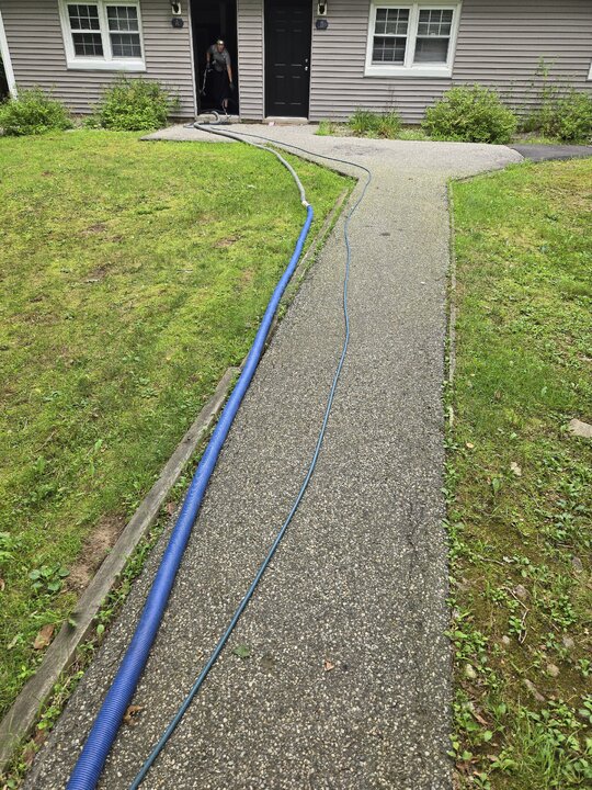

or something to keep the hoses off of grass? I order them neatly when I setup a job but then I walk out to the truck and they are all over the place. Once I get my new heat exchanger installed I am concerned I'll walk outside to discover burnt lines of dead grass across people's yards...

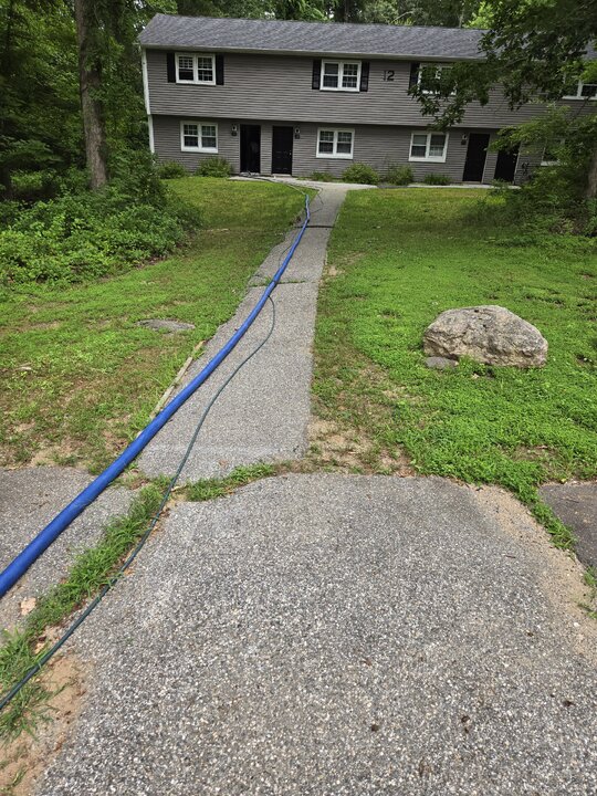

I “think” you have to be around 240 to worry
Once I get my new heat exchanger I think I will be between 230 and 240. I'm surprised how hot the Salsa/blower exhaust heat exchanger gets the water. They say it only adds like 40 degrees but it seems like way more than that, It's piping hot, to me anyways. Seems like it will be scary hot when I get the new heat exchanger in.

I've already noticed a few spots we've been at where we'd have to cut the heat once it is fully functional because there would be no way to avoid laying solution line on the grass. Those stakes look sweet. I'll keep em in mind!

Grass is not your enemy. Ok, fancy rich people grass is, but I haven’t found a need to buy those yet
Your real problem with your hot hoses will be those squiggly black lines on an asphalt parking lot. Your hoses will melt that asphalt and it’ll melt on your hose. And if you bring that mess in a home, it’ll burn itself on the carpet/floor. That’s a real problem

Maybe I should just stick with my salsa heat exchanger and keep my chemistry and dwell time dialed in. Seems like it will make life simpler. I bet hoses and fittings last way longer too.

But I did spend $1600 on a heat exchanger. I should give it a try. I'll remember to not keep it on full blast with the heat...

I never used yard sticks but have been known to slide the solution line down a 50 footer of vacuum hose for protection.
Works great here in the Northeast in the winter also.
