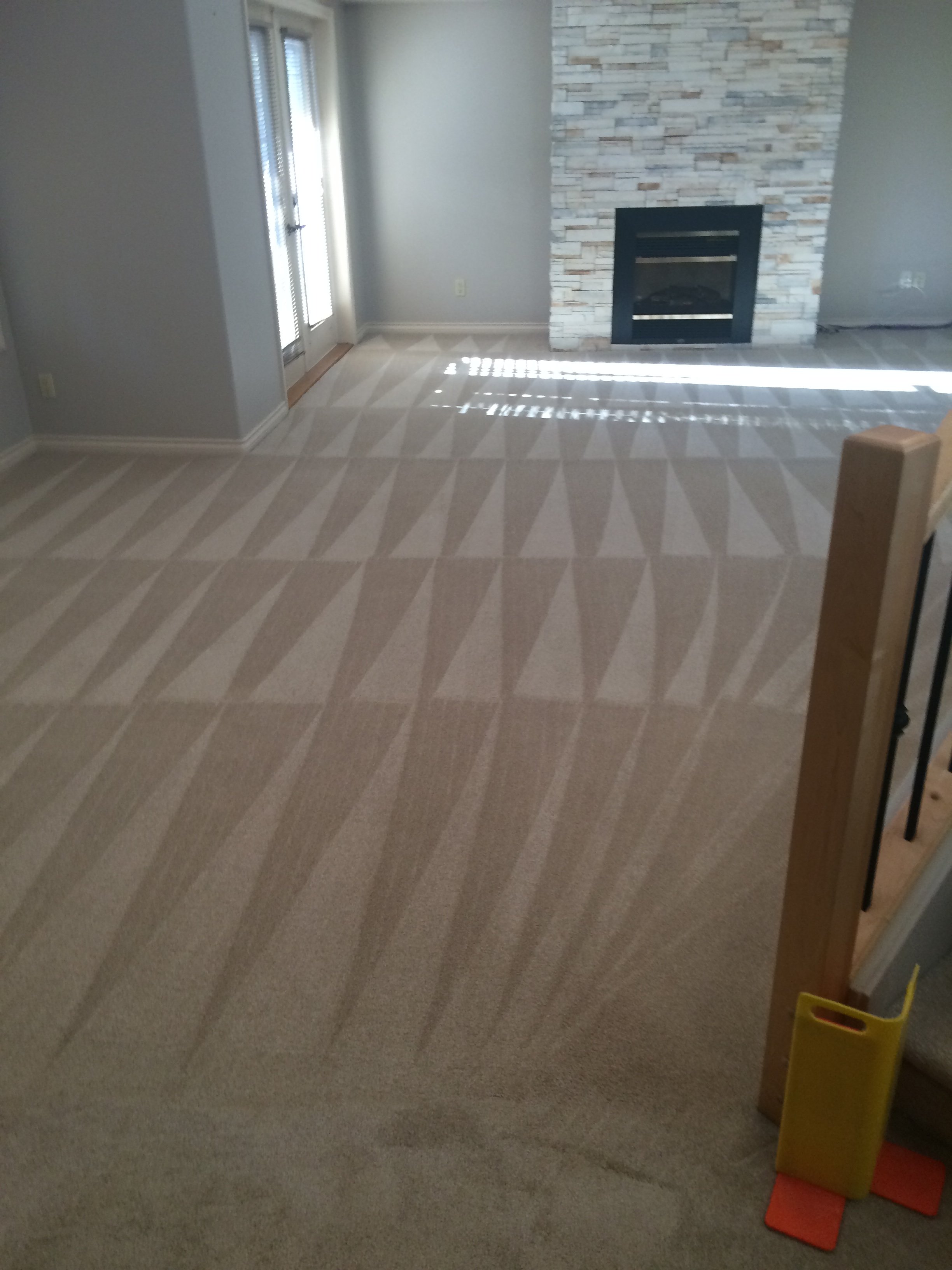

Guess I’m lucky then.... they moved EVERYTHING, and vacuumed both directions, just as instructed... 538CA2E6-5DEE-4709-AF87-EA1E24FCA1D8.jpeg

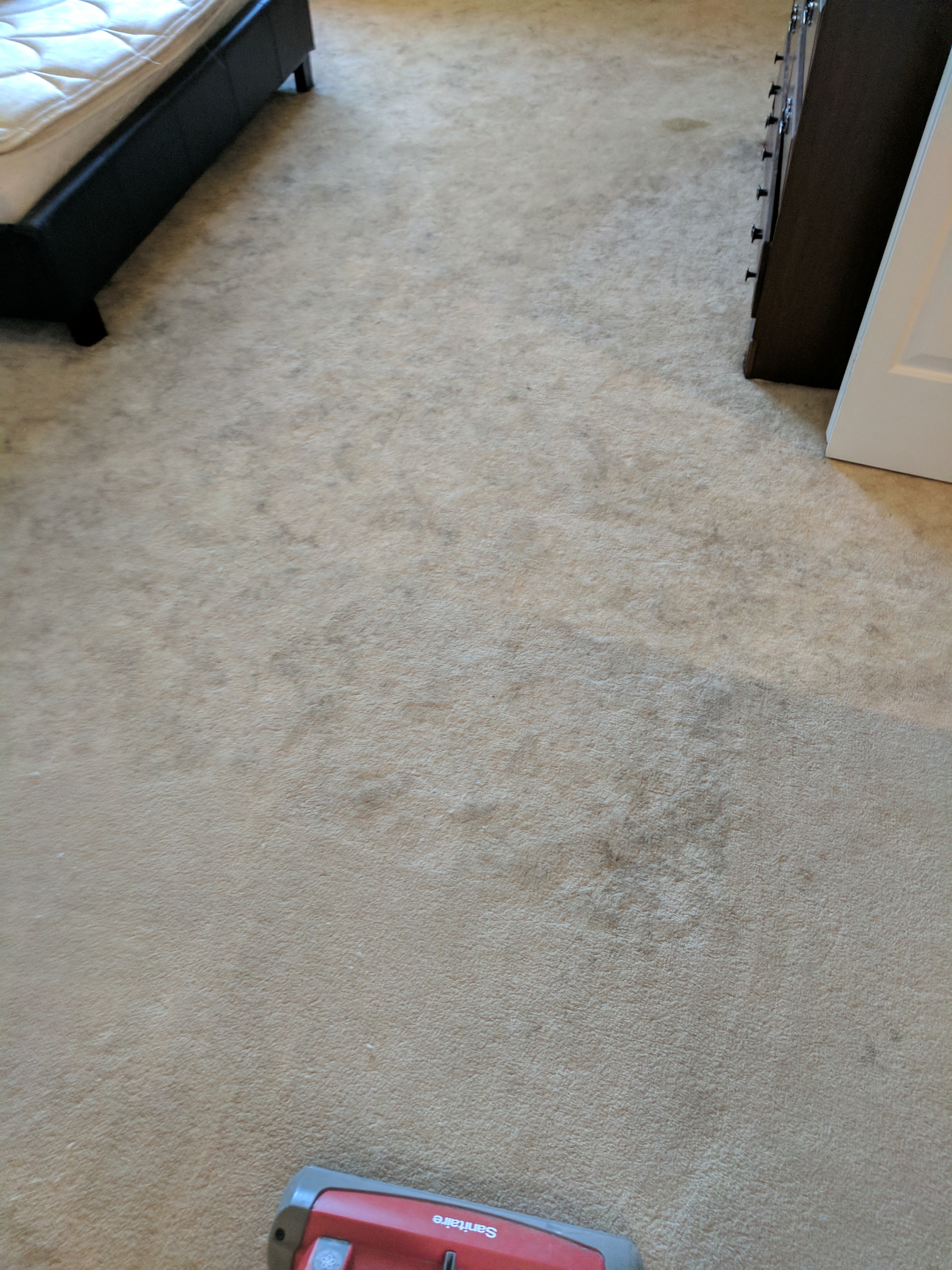

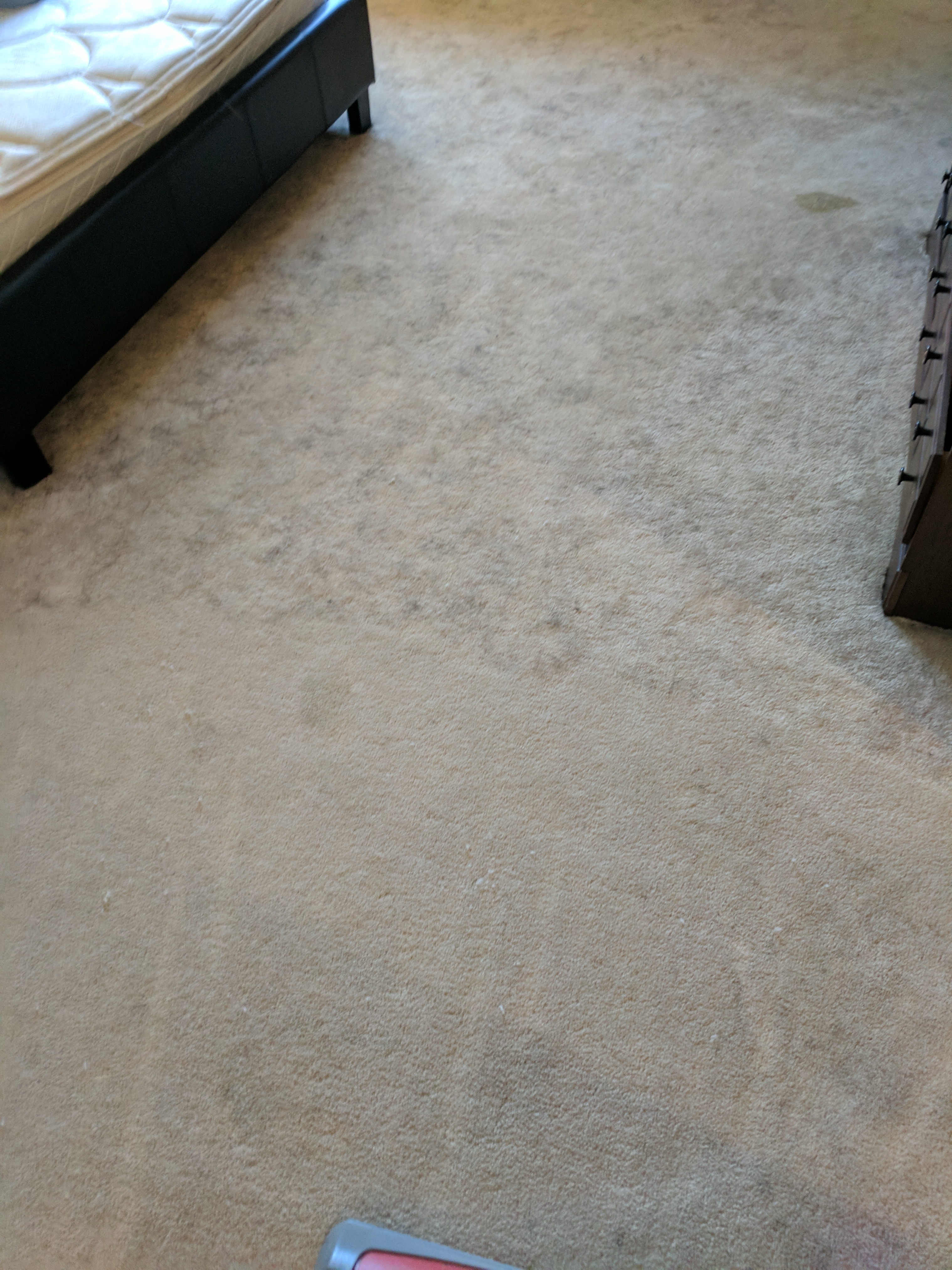

I knew there was a catch. She forgot to tell me that her vacuum broke LAST YEAR. Wall to Wall dog hair. Black dog, black dog, have you any wool? Yes sir, yes sir, 3 bags full. That's what it took to vacuum her carpets.
View attachment 89668View attachment 89669
I hate it when the people say ‘my vacuum broke a WHILE ago’. We all know what that means...
I went and did a quote at a flooring store today for their carpets. As I was measuring up, there was a warehouse dude rolling up an area rug. He went to pick it up, and fumbled, dropped it, and the angle of the sun was just right coming through the store window. The dust cloud was seen by all the front end sales staff, and immediately I asked to see their vacuum. My contact took me into the warehouse, and showed me a Taski vac. FLAT FLOOR TOOL.... the carpet is 9 years old, and so is the vac.... I opened the canister, and I bet it hasn’t been cleaned in a year or 2.....
