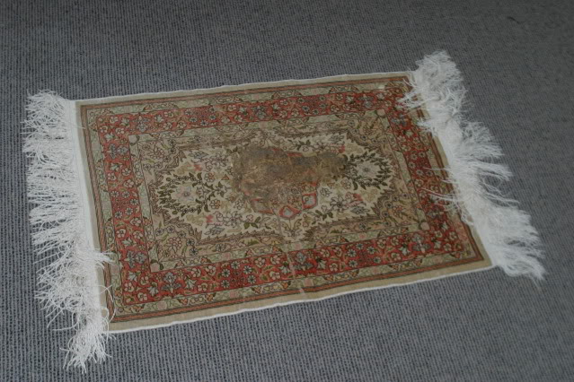

Hi guys, got this baby in and wondering if you have any suggestions.

Check colorfast... but if color is all clear, I would talk with customer about texture damage and wash it, makeing sure to groom often.

I personally haven't colour fast tested yet, but subject to that being ok, I had wondered about a soak for a few hours and then low pressure wash off to see how much of that crap will go. Then use some tanin spotter for the doggie doo staining.
I use a very soft broom for agitation/grooming on silk... is that best or another better option?

John, your procedure sounds pretty darn close to what I would do. If the texture goes or is gone already I can generally get a good improvement with the four way groom process and a carding brush.

Just wash it down, should not be a big deal. Make sure the spray of the hose is with the pile and you will not have a problem with the texture. Colors should be safe, but setting them with vinegar might be a good idea (just in case).
