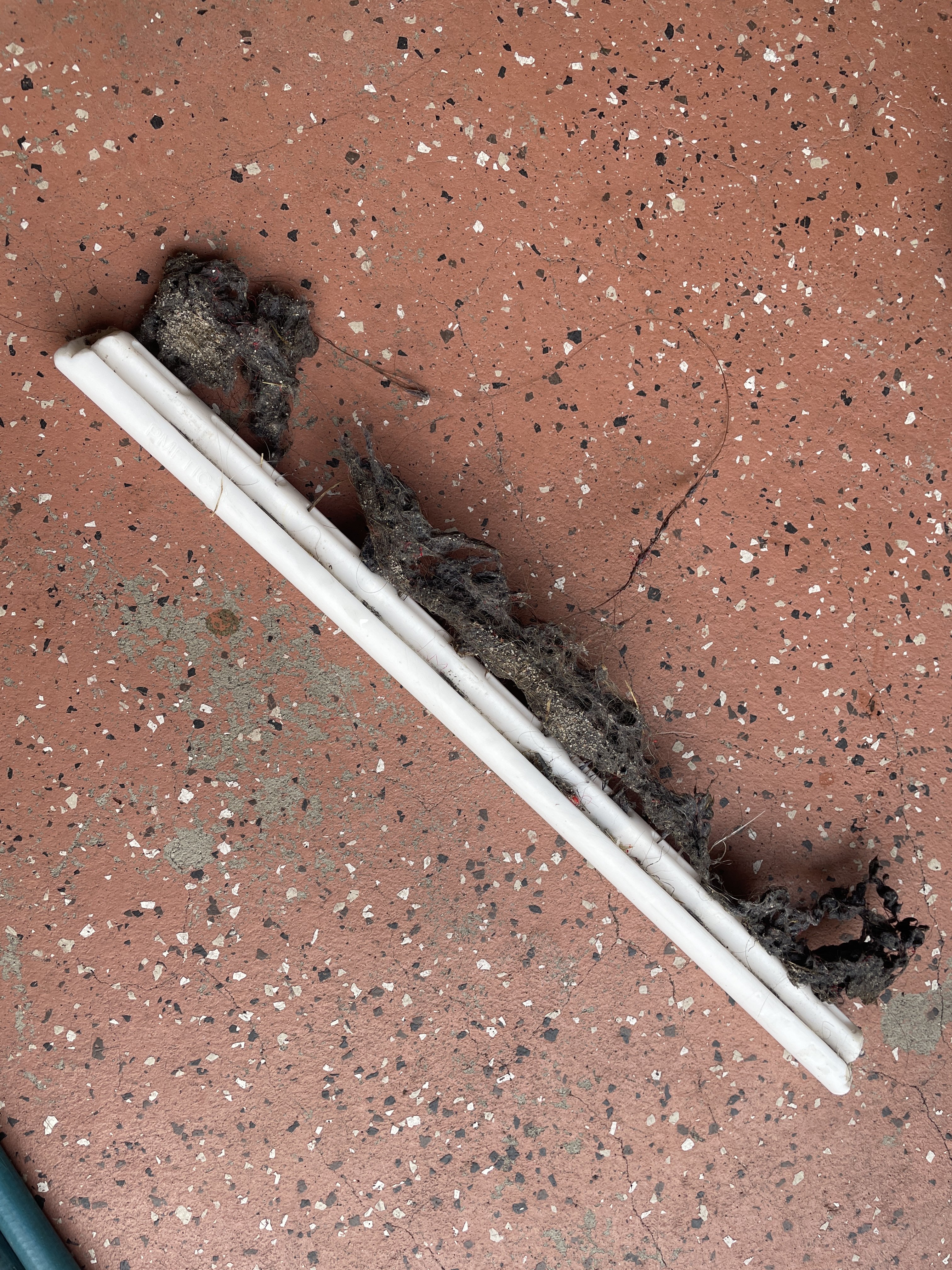

Your Glides. Sneaks up on you. This wasn't even that bad...

This was over massive sq ftg. There was no way to do this job without the Greenglide. I was impressed how much the glide grabs if you don't vacuum. Didn't feel the loss of vacuum either, 200 ft run.
The Mach 15 with the slot glide kicked ass. Broke out the PCQJ to drill heavier soiled areas with the Slot Glide. Didn't want it to get jealous.
The other advantage is you ball up the wad and send it through to bore out the vacuum hoses. Cleans em up. Very sustainable.

A cleaner in West Virginia asked me to stop and see him when I was in the area. His people were shrinking and browning carpets (yes, it was that long ago when both conditions were more common than now) and he was convinced it was because his truck mount was running too hot.
I doubted that, but said I'd check it out.
It seems his wand was so full of debris (it started with the center pin that kept the wand opening from collapsing accumating fiber and went on from there) that the wand was completely clogged.
After slicing and digging with a coat hanger, I got the wand completely cleaned out. I asked the operators when they last emptied the waste tank.
They both looked at each other for a long time and shrugged.
They did say the wand was easier to push before I cleaned it out....
