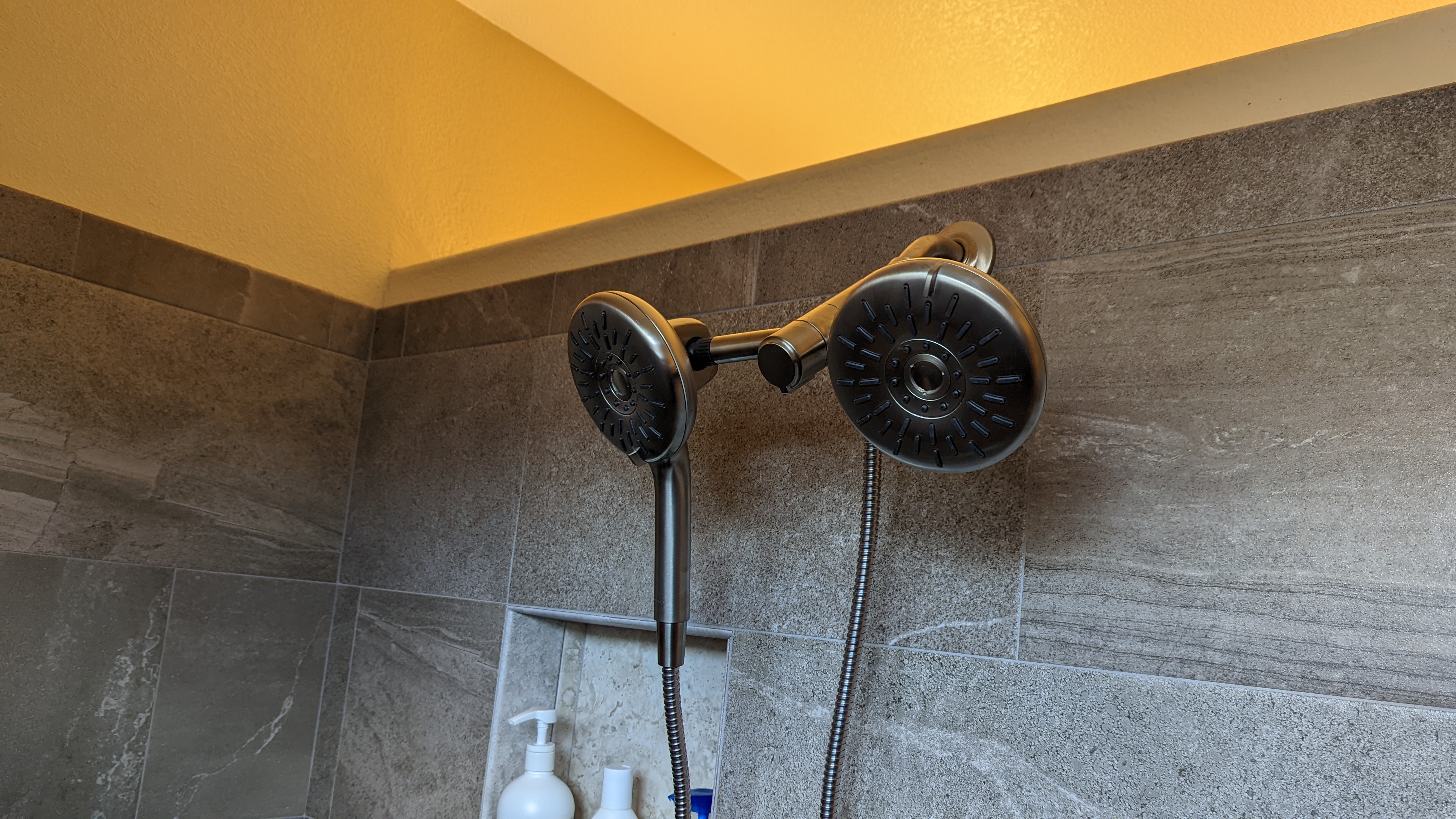

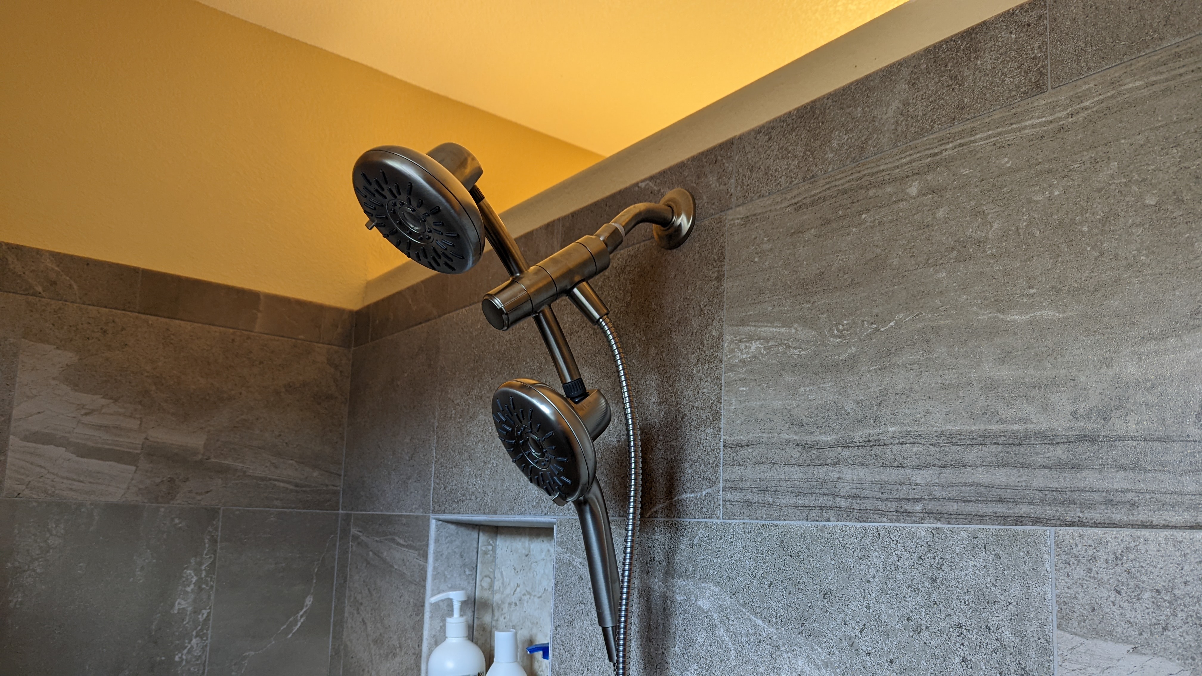

I got a new dual wanding machine today.... PXL_20211208_211548903.jpgPXL_20211208_211536635.jpg
