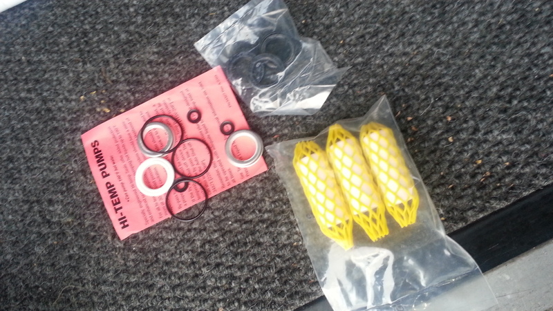

Who can tell me why my General Emperor pump on my Judson can run dry/without water circulating all day buy if my pos Cat 5cp runs dry for a few seconds the plungers crack and the main seals get shreaded..?
Packings w/teflon/graphite coating according to their sell sheet

like a good boss all first mistakes are ultimatly MY fault.
THe second time it's on them.
Tank got ran empty and he continued to spray for too long.
By the time I filled her up and tried to prime the pump it was toast.
Or who, knows, maybe I ****ed it up priming it.
This new High Flow pump has been a PITA, my old HP pump never had seal issues.
anyways $450 in parts later (yes $450) we're back in biz...

Mike, looked through this a bit yesterady. Couple things going on here. First I know often it isn't intended but it isn't good to run a pump dry, just like it isn't good to run a car engine dry. However, like many motor oil manufacturers do with creating blends that better handle the worst case Cat Pumps also worked to remove the problem.
Most triplex pump manufacturers use Buna seals as their standard seal configurations both for reliability and chemical compatibility. They work well in many materials and applications. Yet Buna seals typically have a max rating of 160 degrees F. Depending on your location (ambient temperature) and the length of time you run dry you can reach 160 degrees at which point you can start to break down the Buna seals.
Cat Pumps developed a set of low pressure seals that would withstand much higher temperatures. The ST2 or ST4 (Cat Pumps models that end in .3400) seals that are used in other high temperature applications. These seals are typically rated to 240. The internal testing showed these seals would withstand the run-dry occurances with very minimal impact to performance. They have been around for more then 5 years but I don't think many are aware they exist.
I have also heard in some of the forums that ceramic plungers sometimes are cracked. This is typically a result of thermal shock. Let me relate it this way. Let's say you took your stone serving dish and heat it in the oven to 450 degrees. Then immediately took it out and dumped it in cold water. The rapid thermal expansion of the stone could cause it to crack. While this may happen say less then 10% of the time it is possible especially the more extreme the differences in temperature.
Not sure if this helps. Cat Pumps has a solution and a number of people are using these seals today, I just think many are not aware of it.
