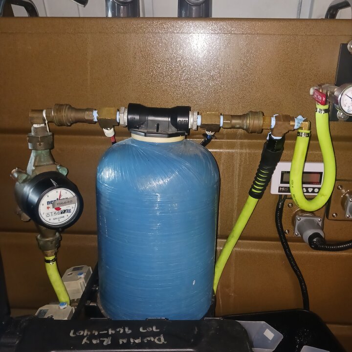

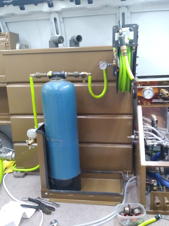

Hey y'all. I'm thinking about incorporating a water softener in my setup. There is a lot of hard water in my area. I want to remove variables and improve my efficiency and results on the job.
What is the lowest/easiest maintenance water softener that has a small footprint you have found? Does it restrict the flow rate of fresh water coming directly from a home?

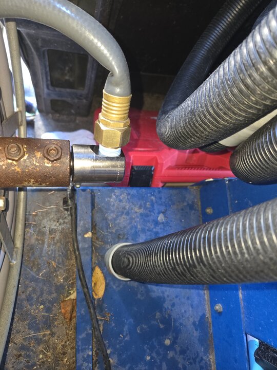

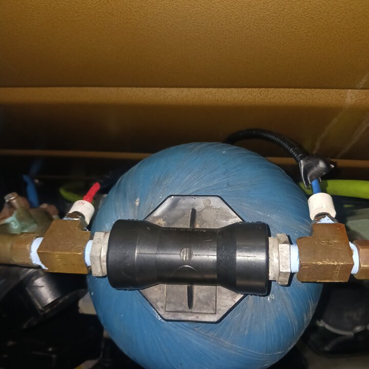

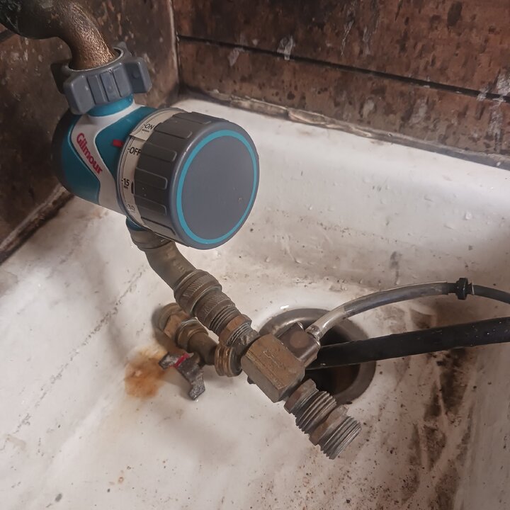

I still use the old prochem softeners.(1 cubic foot) I hear some guys use a little one that they get from Costco. But the amount of time between recharge is (or at least if properly done) a lot shorter ( i also have a flow meter and "kinda hardness meter" installed) you can find them pretty cheap they recharge with a dema valve( like a hydroforce). If you get a used one i recommend replacing the resin. It's supposed to be done every 7 or so years
20220701_181706.jpg 20240731_122908.jpg 20240727_115300.jpg 20240731_122940.jpg 20241028_145700.jpg Screenshot_20250902_083429_Gallery.jpg 20231129_103108.jpg

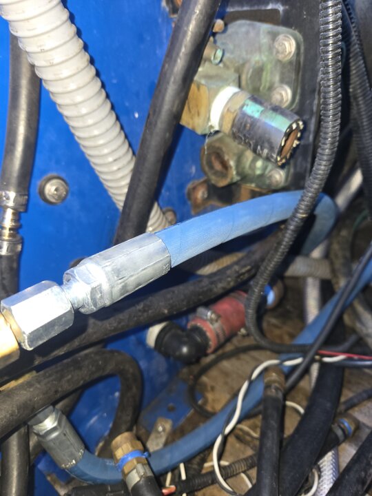

I just finished installing it all today! I was going to post some updates about it tomorrow. I went and swapped out all my high pressure lines with new ones at our local supplier today, and had some new lines made to plumb in the heat exchanger. It all seems to be working well, no leaks in the lines or fittings, and the cavitation is fixed too. I have 3 jobs tomorrow. I hope it all works well and I finally have proper heat.
The pressure pump is leaking a little bit. It is coming from the pump itself somewhere. It is an old pump, I don't know how old it is but it may of been original with the machine from 2013. That General Pump is now discontinued. I am considering spending the money and just getting a new comparable model, then rebuilding the old one and putting it on the shelf. The floor around the pump is a little crunchy. There were probably long term slow leaks from before I got the machine. I haven't noticed any since I have owned it until recently. It is only showing through underneath the van slightly. I need to nip it in the bud while it is still solid enough to keep trucking without major work...

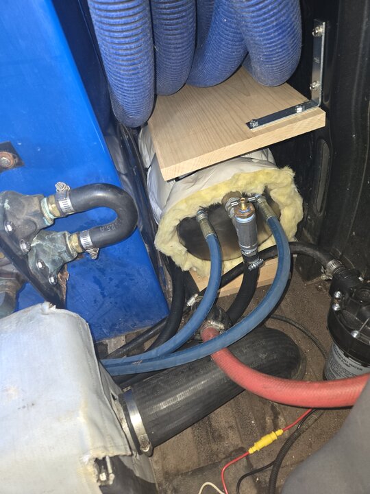

Bleeder valve, water heater insulation, and a shelf so I can still throw extra hose and things back there. All stainless fittings with stainless steel teflon tape, hopefully it doesn't need any attention for 5 to 10 years :]

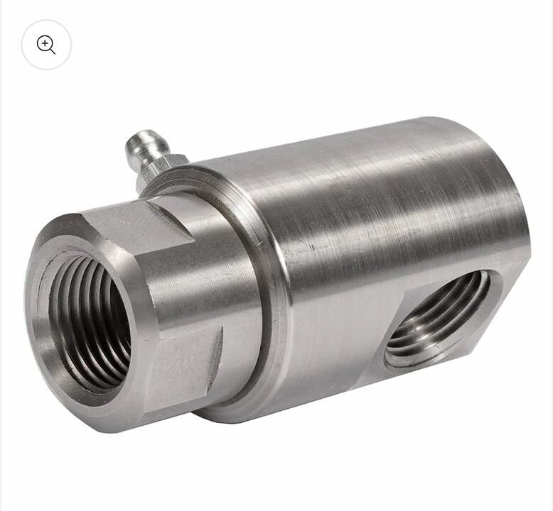

Dwain, I got a new live reel fitting for our garden hose. The old one was seized, the previous owner never greased it. $150 for the swivel fitting, man that's an expensive fitting. But it saves so much of a pain in the butt.
I also replaced all my high pressure lines with these, they seem really solid and are rated for 6000 psi. The smallest pressure lines are different just braided steel. The whole rig feels so much better now. Next up, new pressure pump!

Thats real expensive for a live reel swivel. Thats about what i pay for a rx20 rotary swivel. These are what I've been useing on live reels for as long as i can remember. Every 2 or 3 years i put in a $7 seal kit. I just pop a spring clip off the end, pull the block off, remove & install 2 oring like seals a dab of parker lube oring stick it back on good for a couple more years. I get um from Windtrax car wash supply

I did pay way too much for the swivel fitting. It was just readily available at my supplier when I was in his parking lot replacing a ton of lines and fittings on my machine. It is really nice though, and has a grease fitting on it. Hopefully it will last for many years.

I used my Blue Baron heat exchanger for the first time today. The thermal relief valve is shot and my waste tank kept filling up. I'll clamp the rubber hose shut or install a brass plug for now until the new one shows up.
The heat is great, it takes a long time to make its way to my wand though. The system heats quickly when I fire up the tm and open the valve to allow hot coolant to flow into my hx. There is just a lot of cool water in the 150+ feet of solution line that needs to get out of the way. I suppose I should blow off a lot of water through a tool before I go in and start cleaning so I can utilize heat on my first wand passes...
The heating capacity is deep though. Seems like the more I pull on it the hotter everything gets. There is 80 feet of tubing in the Blue Baron hx, and I added about 4 gallons of engine coolant to install it ✨
