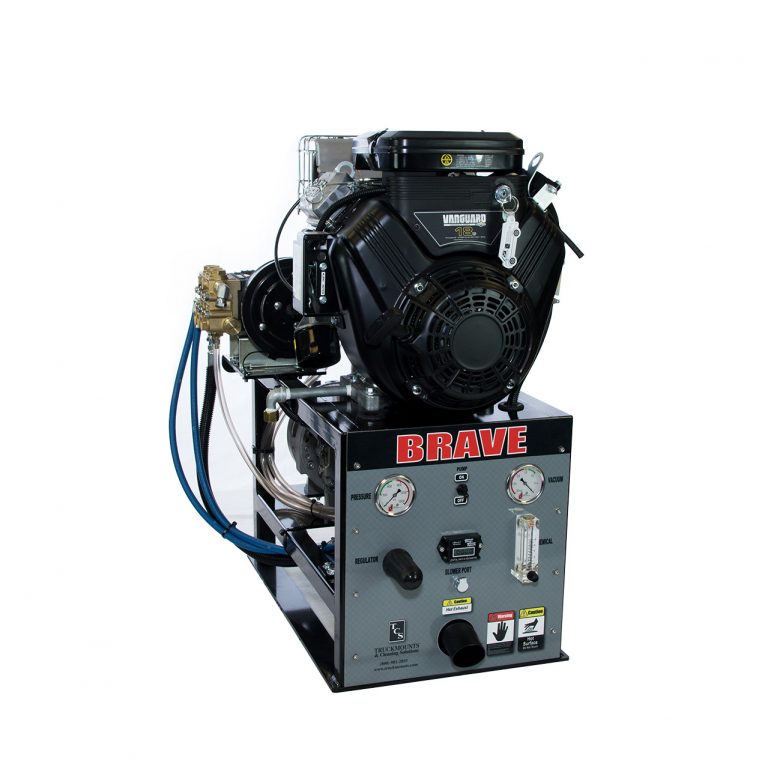

There is an enormous amount of experience on this board regarding this issue
DO NOT under any circumstance buy an ETM!
You will regret it and be seeking and tweeking for more power and efficiency long before the first vac motor craps out
The solid advice here is repairing your existing unit if you are cash strapped
Then invest your money in getting sufficient work so you can afford to UPGRADE YOUR PRESENT UNIT
how much is this TCS TM????
and how much will a plastibox porty vac in van cost with a big enough GAS generator and heater??
bet it's not all that much less than a more powerful Little Injun ...and WAY smaller package to boot
