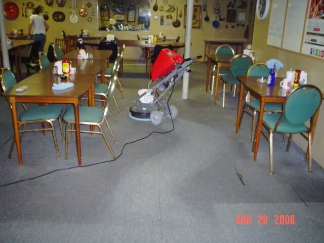

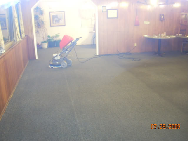

I just went back to a commercial that I used the TM on, traffice areas were still looking rough.... ran the Cimex over them with some encap juice and POP!!!! they looked awesome.

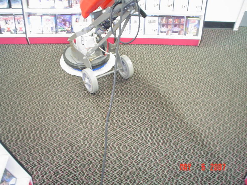

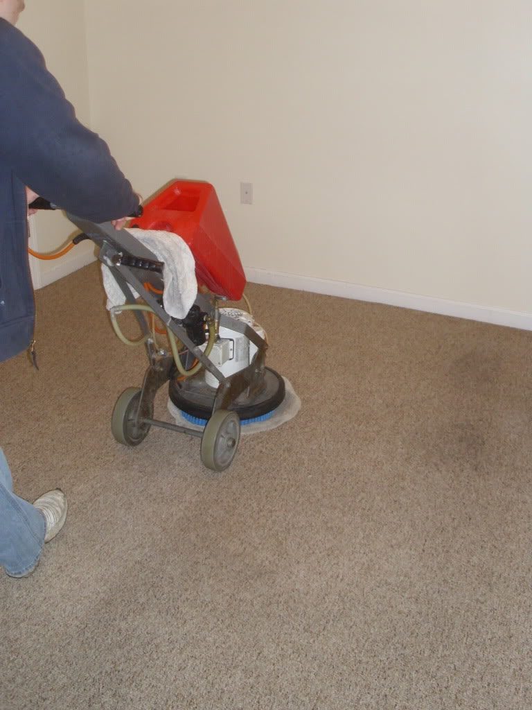

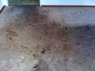

I cleaned this carpet a while back when it was newer. I applied FiberCop when I was there. Some nasty tenants moved in and made a mess of every thing. She said she was going to toss this carpet it out. I thought I'd see what I could do with it since I was there cleaning anyway.
I borrowed an Orbot to see what I could do with it. Pre Vac'd. Pre-sprayed with Encap punch boosted with lots of peroxide - scrubbewith Whittaker CRB. Used Hell Gel on a few spots. Padded with cotton bonnets on Orbot. Sprayed some release it DS while padding.
After I took the pictures I rinsed the carpet with my TM. It would have passed for clean, but since I was cleaning the other areas while I was there it was no big deal.
These are not fakes.

Walt that is an old technique of the SHAMPOO and Rinse.
I would have just used powerburst/peroxide prespray and scrubbed with a 175/shampoo brush and extracted.
No need to use expensive encap chems on a dirty rental.

The AFTER picture was taken BEFORE I rinsed it. Even though it looked good I just couldn't let it go.

I installed a 12 volt winch in my van so I can load and unload the Cimex by myself. I used it on a high school cafeteria that always gave me problems wicking with HWE, the cimex made it look great.
